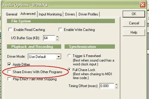

In order to use 'em both at the same time, you must "share" the audio driver. In SONAR, go Options --> Audio... --> Advanced tab, and check the "Share driver with other programs".
