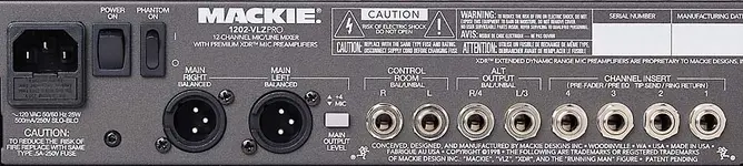

joro,
Problem is, my mixer doesn't have its own output pot for each channel. I've never heard that... then again I don't have much experience with mixers so... The tech support guy for Mackie actually told me to use the main out on my mixer to connect to the input of my soundcard. My mixer is a Mackie 1202-VLZ Pro. It has a Alt 3-4 feature that allowed monitoring a channel while not recording it into the computer when the channel is muted. That is exactly what I did. I un-mute the channel that I want to record and mute the channel that I don't want to record (this is the playback channel). Still, the playback channel (that's muted) bleed into the recording channel. Why is this?
Thanks for helping joro
ummm...
Yes...
Your mixer does indeed have some individual outputs for channels...
I have a 1402 VLZ Pro...same thing really..
look on the back side of the mixer......the side where the power cord is....right behind each channel dude...
see those pots?
Those are the outs for each channel..
The tech guy probably didn't understand what you wanted to do...
check it out man...and good luck,
Joe
use the insert channels..the 4 on the right...#1 will work for channel 1 etc.
