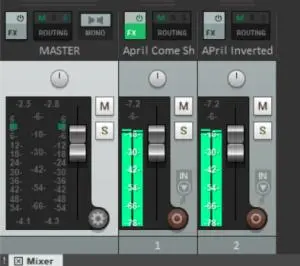

There's an easy way to see of the process is neutral. Simply load the two files into the DAW, invert one and sum them. If the sound has been changed, you will easily hear something. If they are the same, you should hear little or nothing (depending on dither, level matching etc.)
I took one of my recordings, inverted the phase and rendered it at 0dB level. I then added that track back to the original and played them. You can see that both tracks are reading healthy signal, but the master, which is the summed signal, reads no signal. The input equals the output.

I never thought of doing that! such a simple test - never too old to learn new tricks!
Excellent idea. I ran the test with several different samples and got some useful results. Both the GarageBand export and the Audacity export (both with no added FX) completely zeroed out the master meter when I flipped the phase and played against the original. (I wonder if that means my ears, or mind, were deceiving me when I was first sour on the GarageBand export.) When I did the test using exports with FX added, or exports of different file types like MP3 etc, there was plenty of noise left over when the inverted file was played against the original.
