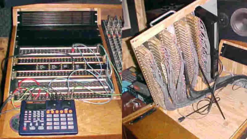

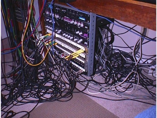

yeah..patch bays help keep thing tidy too. (modeled from T.Rats....'member?)
