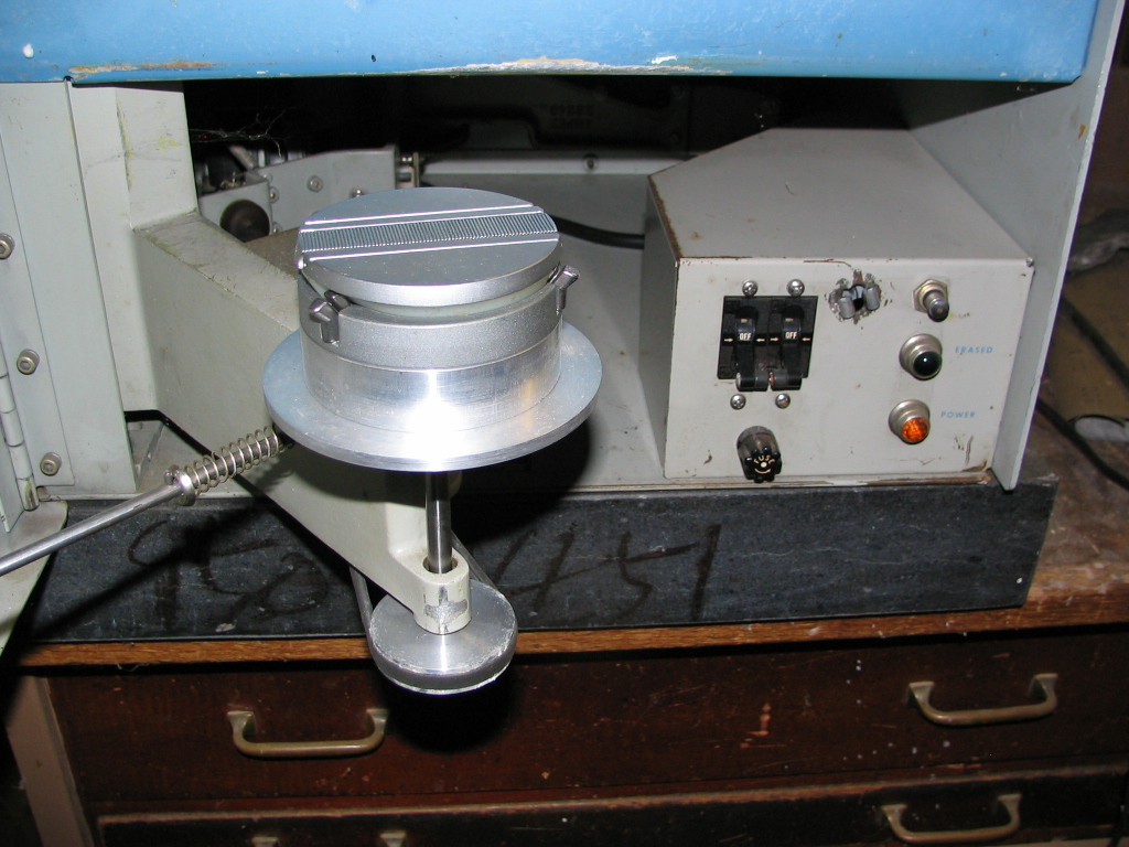

I've also got this:
I've also got this:
sweetbeats,
I don't know why,...
But I really like that thingamajiggy tape eraser!
Saw it in one of you other posts.
That machine is sweeeeeeeeeeeeet!:D
I just like really odd old/vintage stuff like that.
Does it work?
I haven't actually tried using it yet, but it powers up and hums and the reel table spins when you actuate the proper switch and shut the door. I'll know more when I can test it on a tape. When I first got it with the MM-1000 I didn't even have 1" tape to try it on, and once I had tape and had run some tests on the MM-1000 I'd sort of forgetten about the SE-10 (that's the model of the Ampex unit).
I'll know more in a month or two as I have four 1" reels and six 2" reels of 499 that are used that'll need bulk erasure.
I'd bet money it works. Notice the Ampex asset tag on it...this was in their one of their facilities somewhere.
You load the reel on the table, lock it down with the instrumentation type clamper and then press the switch and close the door. A motor rotates the tape reel while the degaussing coils pass above and below the reel. Its all automatic. When its done the appropriate lamp glows. It weighs at least 40lbs.

Now you've sparked my curiosity...
It only erases 1" & 2" tape? What keeps it from erasing smaller sizes?
That's weird. :confused:

Oh...duh...yeah...I only mentioned 1" and 2" because I'd [robably use the handheld Inmac just for convenience on the narrower stuff ATM...and the SE-10 has that AWESOME instrumentation reel clamper...and as you see it in the picture it is setup for 1" tape. I'll have to have my machinist friend make up a thicker spacer for the 2" tape...and I'd have to do the same for more narrow formats or stack them up. So I guess that's the biggest reason is that it gets kind of setup for one format, not that it can't physically degauss others. You'd find one of these at the TV station by the quad video decks and so they'd only be degaussing 2" tape. I imagine this SE-10 is setup for 1" as I have a feeling it has been hanging around with the MM-1000 which is setup for 1" and there were a whole bunch of video sweetening reels that came with the MM-1000, which spent some time at Universal Studios at some point. Pink Panther Returns, Mary Poppins...can't remember what else.
