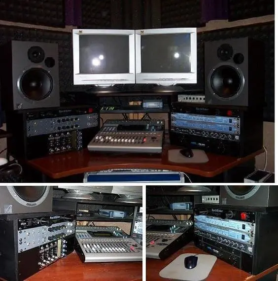

I built this 12 space desk-top rack a few years ago.
I made it from poplar wood, which is inexpensive, and easy to work with.
All the joints in it are blind daddos.
The difficult part was measuring accurately for the side supports that the rack rails are attached to.

Well, I bought a computer desk from Wallmark for around $40, rack rails off of eBay for around $10, a couple peices of wood and misc. hardware from Home Depot for another $10 and with a little creativity, everything worked out just fine. A great recording desk and most of all, alot of fun to put together.
BTW ... I currently only use the rack for a power amp for my monitors, but it appears PLENTY strong enough to handle a full load.

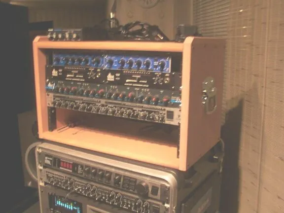

My buddy helped me toss this rack together a week or two ago. It is 6 spaces and it cost me about $29 total. It would have been less if I opted to not buy the more expensive handles.
