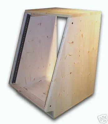

And this for rack devices, stained to the color of your choice. :)
Beck,,,is this a rack you made?? Or is it available for purchase somewhere?? If so, do you know from where how much. ;)
