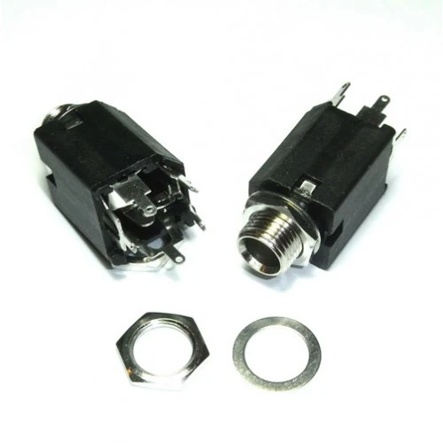

Probably feasible to disassemble, but likely will entail taking quite a bit of the mixer apart. Guessing all the knobs and nuts that retain the controls on the front panel would need to be removed and then possibly the circuit board to which the jack is mounted. I have a feeling to remove the plug tip from the jack you'll also need to unsolder the jack from a circuit board, as I suspect the jack is similar to the one in the image below which doesn't provide easy access to the piece stuck inside. You may need to push the piece out from the back side of the jack which would necessitate its removal.

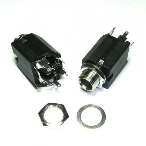

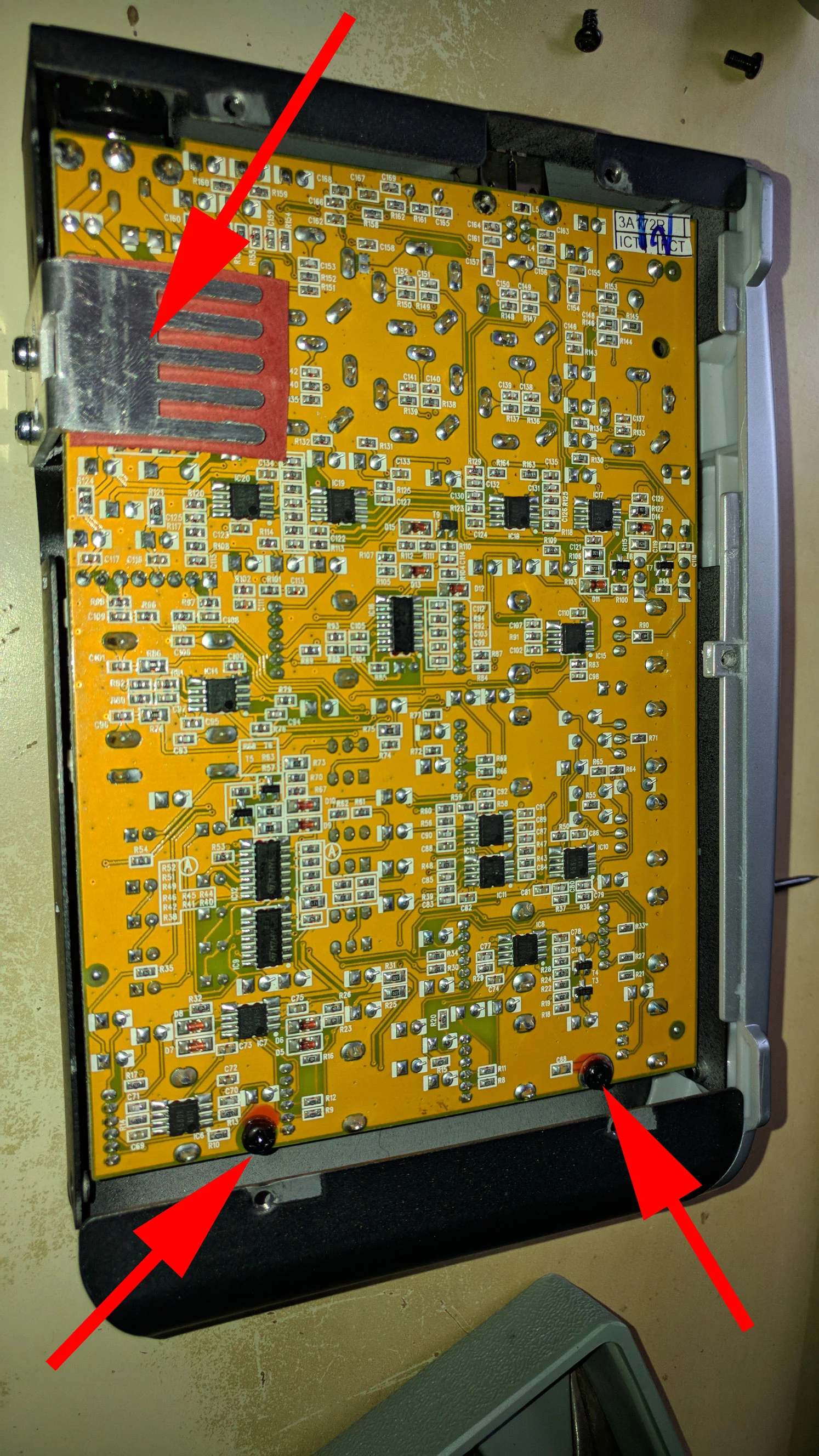

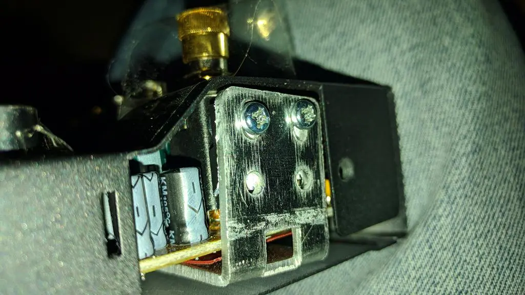

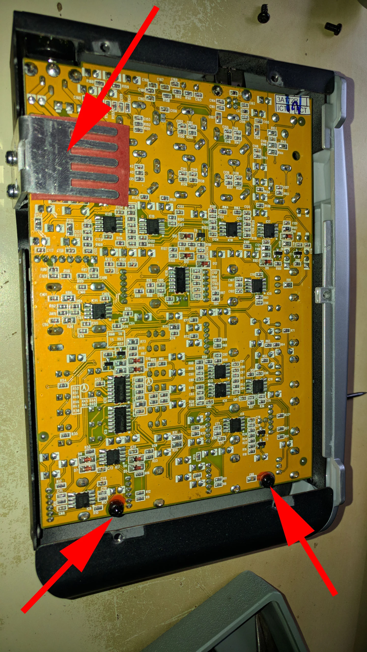

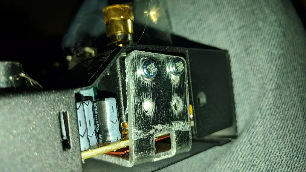

Here are pictures of the part-disassembled unit:
Behringer jack IMG_20180403_155940.webpBehringer-jack-2-IMG_20180403_164438.webp
The top red arrow in the 2nd pic is the underside of the jack socket. The two arrows on the bottom are the only retaining screws for the board. If you look at the top photo you can just about see the gold tip of the jack at the base of the socket.
