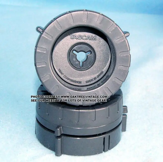

Hello, in place of asking another question because I know nothing, I decided to be an idiot and break my left reel spindle fastener on my TSR-8. I bumped into it and snapped the plastic that holds it tight when fastened. Now it's entirely loose, and goes out of control when being rewound, though it doesn't seem to bother the play for recording too much, at least visibly. Now, is this fixable? Can I buy another? Or did I just make a big mistake? Thanks All
Hi,
Do you mean the reel clamper, called a NAB reel clamper, it's removed by undoing the screw in the centre and just pulls off. I have replaced a few cracked clampers over the years.
When looking for an image I found this site
http://www.oaktreeent.com/Teac-Tascam_Stereo_Parts_Unit.htm
However Tascam may also have them in stock.
Cheers
p.s Dr Zee must have beaten me by a second, cheers
Alan
Thank you Dr. Zee and Alan, and yes, it must be the NAB clamper that I am talking about. Well, happy day, looks like there is redemption for my clumsiness after all!
