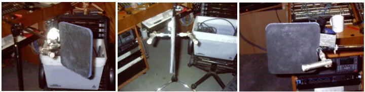

Build a Jecklin Disc using Extreme Ghetto Technology, like I did: 2 oktava's using omni heads sitting on a stereo bar, with the disc being a chunk of styrofoam covered by one of those velvet dogs playing poker things
stand near that drummer and see if there is a place you can stick your head where you dont hear so much cymbals, put the disc right there

A cobbled this together out of a piece of aluminum and a couple of mouse pads.
Hey, I have a couple variations of that: 1) two Behringer omni reference mics with the ends sticking out of either side of a Richard Nixon mask. 2) The same behringer omnis duck-taped to the center of a dinner plate with a wadded-up towel wrapped around the plate, separating the Right and Left ear. :D
Honestly, that is a good idea. My only complaint is that the stereo spread sounds amazing on headphones, but for the most part it lacks a bit. Not to mention that it's hard on your ears to walk around and find a spot when the drummers banging away at ear-splitting volumes. Everything sounds loud everywhere. :D
