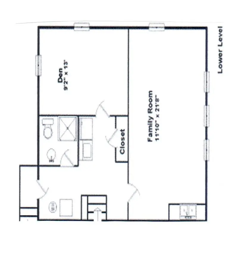

Just bought a house. Will be moving in mid-december. Any advice on setting things up?
Drumset, 2 guitar amps, and a bass amp. It is in the lower level of a tri level house. Linoleum floor, drywall on interior wall and ceiling, cinder block on two exterior walls. Windows on exterior walls. Just wondering if there are acoustic strategies I should keep in mind before hauling all of my shit in and setting it up. I intend to build some acoustic panels/bass traps down the road. It will be used as my band rehearsal space as well as for my little solo drum/PC based recording projects. It is the larger room in the layout.
sweet - nice big space. I would center the mixing desk at the top facing the window a few feet back from the wall, put bass traps in those corners.

I suggest you read a lot here before you start to build...https://homerecording.com/bbs/general-discussions/studio-building-display/
Dig deep for the many great threads in that forum. Worth the time and read...lots of ideas to consider(especially if you decide to add more later).. could save mistakes, extra work and money down the road.
Reading in Recording techniques is a plus too before building..learning what gear best records what and how to place it in what type of room can be a plus too.
Actually, going thru all the forums and reading threads pertinate to your needs is a good idea..time consuming but good.
Just my two cents worth.

Hey, I notice you've got a closet on the plan... you could totly convert it into a vocal booth... :laughings:
Kidding folks, just kidding...
