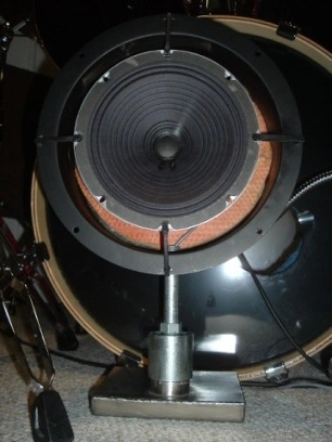

I use a beta 52 inside the hole about a foot from the beater and I made a subkick mic out of a 8-inch speaker that I use right up a few inches off the resonant head. I try to get the clicky, higher end sound off the beta and then just bring the low end up in the mix with the subkick mic. Works well for me. Might be something to think about if your a bit handy and can find a speaker laying around. You'd be surprised how good they sound on a kick drum. Maybe even try the metal washer taped to the batter head - depends what type of music and what you're going for.

Dave, nice sub...:) I'm building one right now. All I had was a 6" sittin around that I'm tryin. Do you use an inline pad?
Hehe no worries. Id actually be really interested in learning to make a sub to get some thumping low end. How on earth do you make a mic from a speaker? Sorry.. Not handy at all! I do have 2 6x9 speakers lyin around tho but dont think they'd b ideal
Yeah, you're gonna need a pad if you don't have one on your pre. I didn't realize how much gain these things have so be careful when first testing it.
