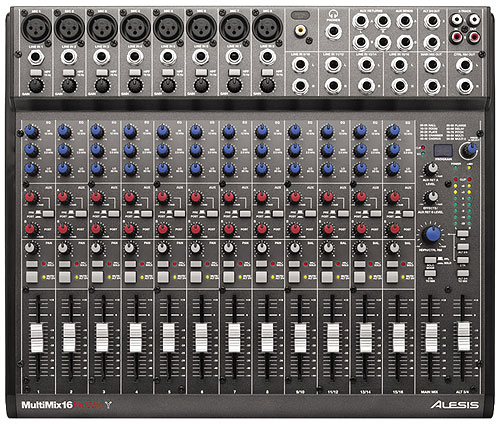

The PROs have a bigger budget and much better equipment but this is how I do it. My console is a Tascam M-3500 24 channel desk. I track to a Alesis HD24 that connects to a PC through a MOTU 2408mkII all clocked with a Lucid GenX6. With this setup, I can track to the HD24 or use the HD24/MOTU as a 24 channel sound card and track directly into the computer. The tape outs from the HD24 patch directly to the tape ins of the M-3500. The inputs to the HD24 are all brought up to a patch bay. This also where all my preamp outputs are wired (inboard and outboard) so I can patch any mic/preamp to any input.
This does what you want in your price range. I use this interface at home: Alesis Multimix 16 USB 2.0
Alesis MultiMix 16 USB 2.0 (16-Ch Mixer W/FX and USB2)
I got mine on ebay for like 475 I think
Depends what the OP wants to record...the Multimix only has 8 mic preamps and, if I recall correctly, only feeds 2 channels back into the mixer, not the full sixteen the OP has asked for.
