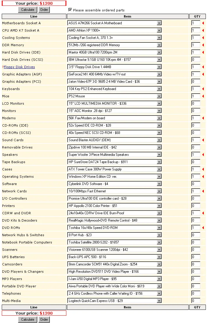

Yes, pretty hard to beat an Athlon XP CPU w/DDR Ram for the money.

Ok. I'm sure this thread has pretty much been answered to death, but it's late so I'm just going to answer it again. I didn't really read any of the other replies so forgive me if I'm covering something thats already been said. If you don't know much about building your own PC, find someone you trust that does. This is a lot of money to spend on a first try. If you don't want to get into the innards and details of building your own, you could look at a Dell and basically, when ordering..just strip it down to just what it needs to run, then add what you want when you get it.
Anyway, $1200 is way more than you would need to put together a decent intel system for multimedia purposes. A good rule would be to keep it minimalistic. Don't add components you won't need. This saves IRQ's, money and time. This doesn't mean buy the cheapest things, but theres no sense in buying a DVD drive and decoder if this is for recording only...
First off, figure out what you want inside and what you'll need to power (HDD's, CD-R's, etc..) A good ATX case can be had for under $100 with a power supply large enough to handle an average number of devices.
Get a 3.5 floppy drive. You never know when you might need it. These are only a few dollars.
SDRAM and DDR RAM is cheap. Get a lot, it never hurts to have too much. Right now I'm running with 512MB.
The processor brand and speed are up to you and your budget. Personally, I think the AMD cpus are a better value and I dislike the P4 for various reasons. Right now I use a P3 550, but with current prices, I would suggest a 933MHz or faster.
Storage is also more of a personal preference. SCSI or IDE, it's up to you. IDE will be cheaper and easier to set up. Usin two drives is also a good idea. Keeping your system separate from your music data can save you a ton of trouble if your OS somehow becomes corrupt. You don't need a ton of space on the system drive, but nowadays, you don't see many IDE drives smaller than 10GB. You'll want a big data drive, 60GB are pretty cheap now.
As for video, it's really not too important for recording audio...a 32MB AGP card shouldn't be too much but get a good monitor. You''ll probably be staring at it for a long time and fuzzy and cheap monitors can be hard on the eyes.
Sound Blaster audio cards are well supported and high quality.

I have to strongly disagree with bnoji on his choice of OS. Win 98 is absolute crap, and not worth considering unless there is no other option. Either win2K or winXP are far, far superior. By now compatability with Win2K is not a problem (except for protools). Win2K is actually less taxing on your hardware resources because it uses them much more efficiently. Win XP is maybe a little harder on graphics, but you can disable alot of its graphics intensive features. If you have a p3 500 or above, your system will have no problem with win2K/XP. To give an example, I'm running a p3 500 with XP now. It is faster and more stable than an AMD 1ghz I have running with Win98.
As far as HDs go, do not get SCSI unless you have lots of cash to burn. A good 7200rpm IDE drive should be capable of doing anything you are likely to want from it at 1/5 the price.
CPU speed is very important, because this will determine how many plugins you are able to use at once. People say Intel Pentium platforms are overall a bit more stable, but for raw power, you can't beat AMD's XP class processer paired with DDR memory. By the way, pentium 3 procs are faster per megahert than pentium4. Intel made p4s less efficiant per clock cycle so as to be able to run them at faster clock speeds.
I reccomend getting certified memory - alot of cheap memory will malfunction. DDR memory will give a significant performance boost over SDRAM, but your motherboard must be DDR capable.
Make shure your motherboard had plenty of IDE slots.

Let me show you what I have and what it costed me, may give you and idea what you can get for you money. Remember most of this stuff is at least three months old so for the most part you can get faster components for roughly the same price.
Athlon XP 1500+ - $130
MSI K7T266 Pro2 (Via KT266a chipset)- $120
512mb Crucial DDR Memory (RAM)- $65
Maxtor 30gig 7200 rpm Hard Drive- $95
Antec sx830 case- $100
Radeon 7500 Video Card- $100
Floppy Drive- $15
Lite-On 24x CD-RW drive- $90
Linksys Network Card- $15
Viewsonic A75f 17" Monitor- $300 (much, much cheaper now, almost two years old)
That is about it for a grand total of- $930. Now this setup is stable, VERY fast, and pretty damn inexpensive. The only thing that may be more expensive now is the RAM, everything else is cheaper. Especially the monitor. What it did not include was the software, I THINK (not quite sure) that you can get WinXP OEM for around $100. Bringing the total to about $1030.
Hope this helps, at least gives you an idea of what you can get for your money.
