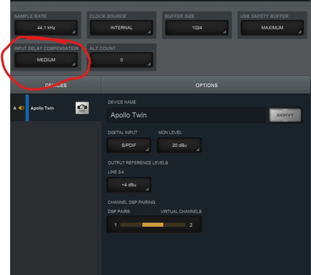

What is this in the menu? Medium?

Should I turn this off?

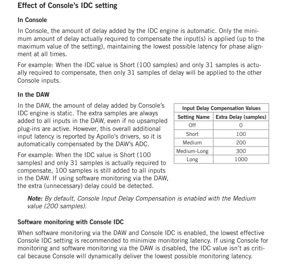

The input delay compensation is to offset the recorded track by the amount of latency of the slowest plug-in. I'm not sure of the details of how and when it is used. I have it turned off in my UAD Console settings.

Did you try recording with the input compensation delay off? I'm curious to see how that works. I'll give it a go myself later tonight.

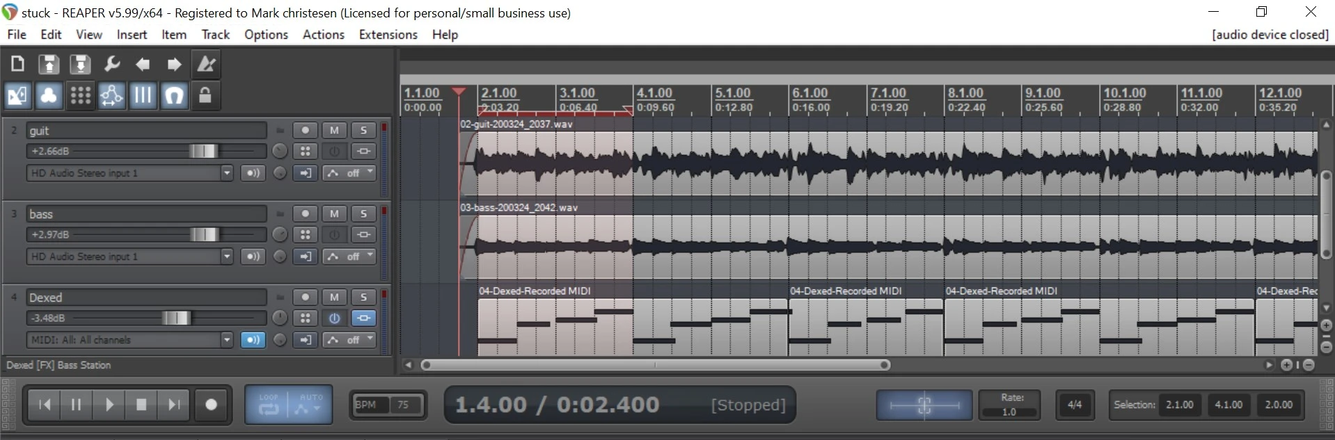

Totally awesome. The UA input delay compensation was turned off, and the tracks layer well in synch with each other.
I didnt nudge anything. What song did you record? I did 'Stuck on You' by Lionel Richie.
Very cool.
Downside of shutting the IDC off is that now in the DAW corner there is 38/60 ms of latency delay showing, instead of 2.8/6. It is constant, so I can work with it.
Here is the mp3 of the short project. I stacked like 6 instruments to crude timing. They line up, the mix wasnt too important.
