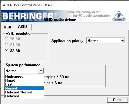

Hey guys, I have problem with my Behringer UCA222 on Windows 10. I'm using Guitar rig 5 software, and I can't setup latency.
On "normal" it works, but latency is high for playing, when I go to: "fast" or above, I'm getting crackling, pops and many crazy noises. I don't have any other drivers installed for audio (motherboard realtek or HDMI audio), I'm using UCA222 for my complete input and output audio on PC.

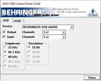

Well I can see the problem with the lower frequencies on youtube - your setting in the Audio/Midi section is at 48K, in the ASIO section it's at 44.1k.

Aside form the 48K / 44.1 K mishap - and the fact that you have the Asio resolution at 32bit but the control panels at 16 bit plays a role. when you get that straighten out the latency should be reasonable.
I tried all the combinations, same problem. Maybe this driver has problems with Windows 10 because it is old.
