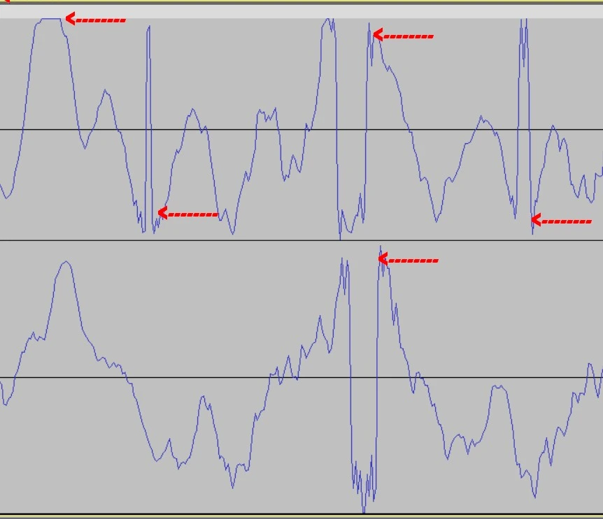

CR, when you say you are far from clipping, what level are you actually hitting? +/.3 from 0? First, you need to determine if it's the microphone distorting, or your recording setup. How close are you to the mic? Back off a bit, around 6-8 inches is fine. Set your level. You should be peaking at least 8 or 10dBFS below 0 on your meters for your loudest points. Also make sure you aren't lighting up the peak light on the Focusrite. Listen for the distortion, and zoom in on the peaks. What do they look like?
There are a couple of things that you see with digital clipping. The first is a simple flat topped peak. The more severe effect is when the signal is so overdriven that it inverts. It shows up as a crackling sound. This was from a cell phone that completely overdrove the input. I've seen the same thing with a couple of other devices, so it's not uncommon. The first arrow points to a flat topped peak. The others are where the AD converter seems to invert the signal. If you are getting those types of peaks, you will hear them immediately. Turn it down and you should be fine.
It's possible to have a defective microphone, but in my experience, they are fairly rare with "name brands". Maybe after going though these steps, you can post a bit of audio (just attach an MP3) and we can listen.
