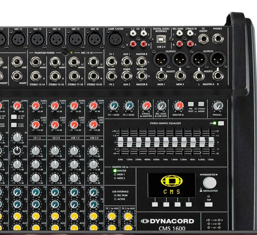

I'm using a dynacord powermate 1600-3... What do you think about it? Could I use the uca222?
You can't make a decent car out of two bicycles and a lawnmower.
What interface should I get then? I need no chanells! Also, where is the monitor output on dynacord powermate 1600-3? I'm looking at the manual but I can't find it...
They're labeled MON 1 and MON 2 and meant for stage monitors rather than studio monitors. The idea is to separate the record output from the control room/headphones output so you can hear the playback plus the live inputs but just record the live inputs. You could switch it around and use the MON outs for recording and the main outs for control room/headphones.
But like they said above, the gear you have isn't really meant to do what you want to do.
