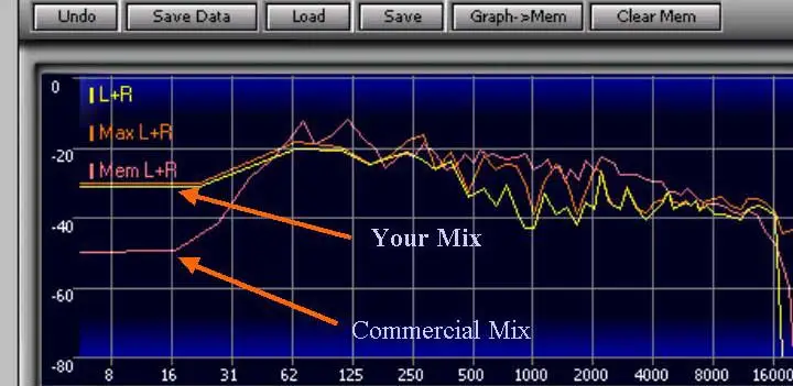

Okay, here, I'll be a smartass, lol...it's SUBSONIC, so I don't "hear" it... (don't hit me man), lol...but I did "feel" it hitting me like a hip hop mix - I didn't feel it until I said screw the nearfields, and I burnt a disc and played it on my stereo. The reason I did that is b/c of your comment that the bass was reacting really differently on different systems...For me, that's a tell tale sign that the mix is pretty hot WAAAAY low.
But then I saw you post, and I didn't wanna' look dumber than I usually do, so I ran it thru an analyzer against a commercial mix that I know is really good on many different systems.
The pic (if you can make it out) shows that you are about 20db hotter at 16Hz than the commercial mix...and really, everything from 60Hz down, your mix is quite a bit hotter.
Read that link...it describes a good way to use high pass (low cut) filters that will prevent this from ever being a problem in the first place...For that part of it, I'll just say that it's very helpful to run a low cut over each track until you HEAR it change the sound of the individual track, then back off a little and run the filter. I don't think it's a good idea to just pick a frequency and hack everything below it...I mean, a good mix NEEDS SOME 50Hz in the kick, right? But by doing the things suggested in that thread, they won't all build up on top of each other and rob your mix of the headroom it needs.
BTW - those aren't peaks in the pic...they're averages. So, ON AVERAGE, you're 20db hotter in the low shat than a mix that I know is great...I don't know where your peaks were, but I suspect they were pretty high to get those averages.

Hey guys...that screenshot is from the PAZ Analyzer, which came with my Waves bundle.
http://www.axemusic.com/products/recording_software/plugins/waves_paz.htm
I like it because it allows you to analyze a mix and SAVE IT to compare to other mixes. Hearing is great, but hearing AND SEEING is even better, eh? I also like it because if you hit "save data," it'll give you a db reading, frequency by frequency of where your mix is peaking, which is really helpful if you need to start using multiband compression on an area.
BTW - that analyzer is compatible with Macs, Rob... I honestly don't know if you can get JUST the analzyer, but just google "free spectrum analyzer" and you should be able to come up with some hits.
[edit] - That was from #3 on your page.

It's got 2 output settings..."PEAK" and "RMS"...root, mean...something, something...I dunno'... As far as getting the whole song, that's a little misleading...I got those by playing the entire song through on RMS and looking at what was left standing at the end.
This is a shitty explaination, b/c I don't fully understand HOW it works...I just know how to use it to compare mixes. I have probably 25 presets saved from mixes that I've heard on my stereo, in the car, on boomboxes, on friends' cars, through PA's, lol...mixes that I KNOW are good for what I do. If I'm doing an acoustic piece with a female vocal, Alison Krauss's "Lucky One" is the preset I'm pulling up. If I'm doing something with (*ahem* ) MBUSTER - then I'm pulling up an overcompressed, white hot CD cut from 3 Doors Down, b/c I KNOW those mixes translate well. For yours, I actually A/B'd it with a country song that I know is fairly bass heavy, but don't laugh...the genre doesn't matter..it's about the mix.
