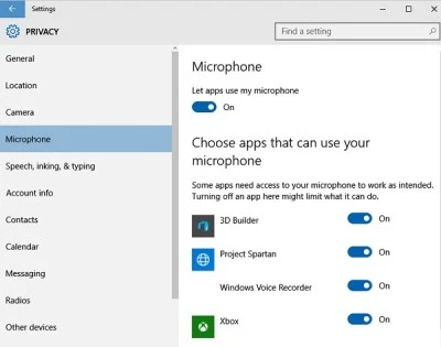

If using Win10, there was a recent update for privacy. It disables mics unless the mic is enabled in the privacy setting. You do get something through the mic, so it may not be this.

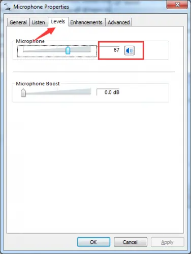

Just to verify, you have gone into the microphone properties in Windows as shown in the user manual and have set the microphone level to a higher/highest value as shown below. I'm not sure you'll have 'Microphone Boost' with a USB mic, my AT2005USB mic did not.
Also not sure which Win10 update did it, but check that the privacy setting allow your mic to be used with apps as shown below.

Ya, I made sure to increase the levels higher. This does help.... buuuut. . . when I get into the 80s (which is kind of necessary) it sounds more like it's just forcing the output sound higher, making is a fake input increase. Idk how to explain it, but I don't like going to high because it doesn't sound like it's truly effecting the input sensitivity, but just forcing it to be louder, if that makes any sense. Ironically, I would think that would be the role of the "Microphone Boost", which as you thought, I do not have.
There is indeed a microphone option in privacy, but it is enabled.
With the CAD U1, I didn't have to mess with the microiphone "level" really. Plugged in, picked up great. But with the AT2020+, it's like I do have to force it by increasing the level to low 90s. Again, my apprehension about this is it doesnt seem to be a "fix" but rather just turning up the volume setting type of thing.
Wanted to follow upto see if there were any other suggestions. But honestly, based on what I've found, the suggestions you gave were pretty much everything :( maybe I'm wrong, let me know. but either way, I've set Volume at 90. This allows to me to record with about 5-6in between me and the mic. Should do the job fine. Just can't V-blog or video record without Mic in frame.
