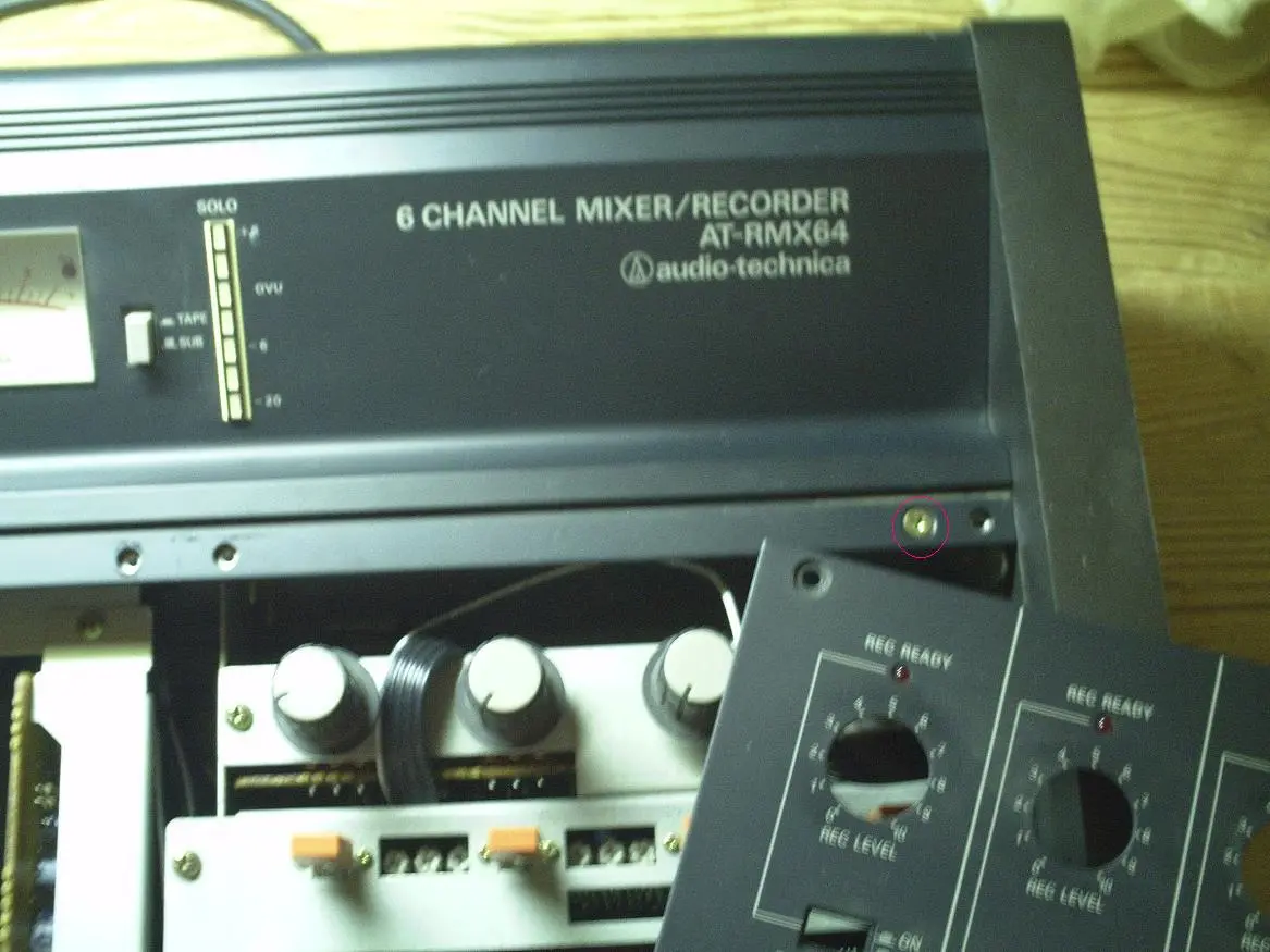

Step 2: Remove front panel screws. There are 16 of them, and they're circled in photo 01.
Step 3: Remove the three screws holding the meter bridge cover on (circled in photos 03 and 04)

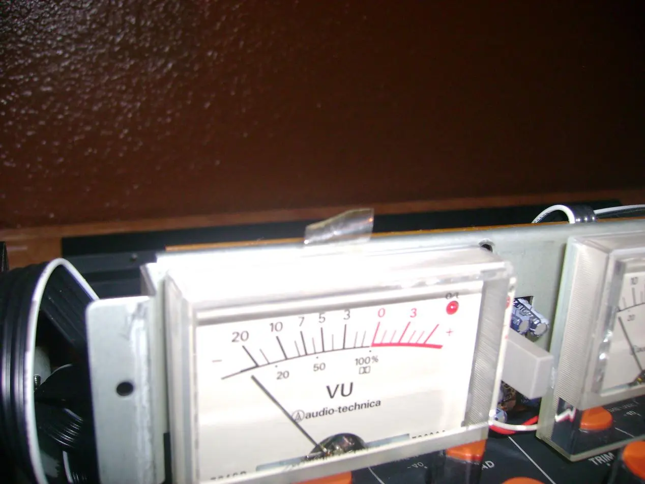

Step 6: There are only pieces of tape holding each plastic meter case on: a reflective strip that goes all across the bottom (you can see these in photo 09) and a piece of scotch tape on the top (photo 10). You can peel these off or just slice them with an exacto knife and retape them with a new piece when you're done (which is what I did).

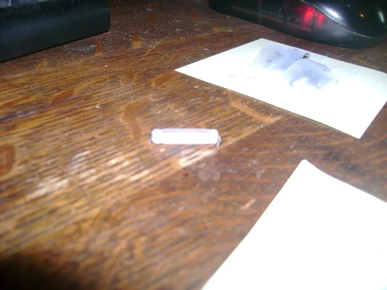

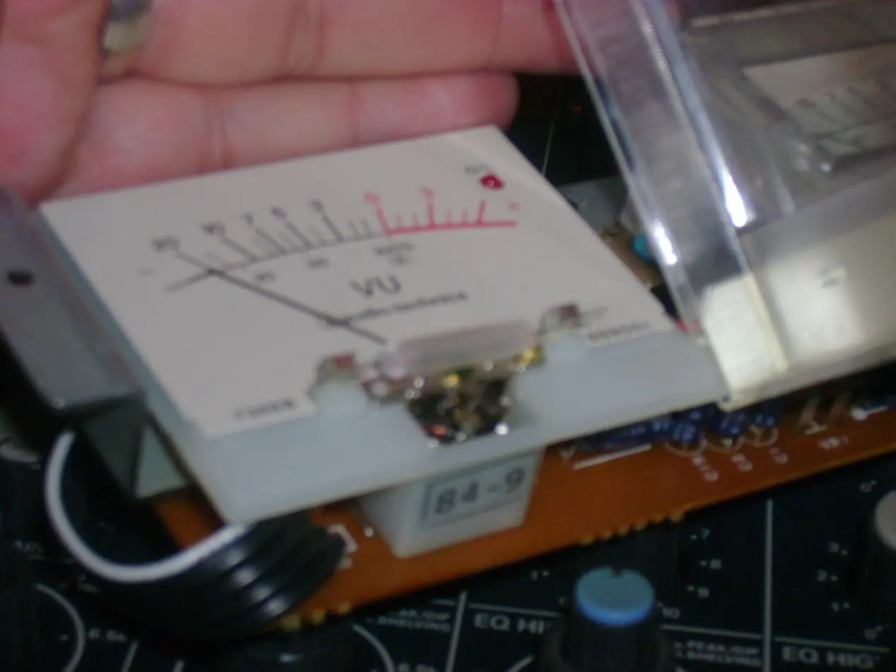

Step 7: Remove the plastic casing (photo 11) and snip out the old bulb (photo 12). Alternatively, you could heat the solder, remove it with a solder sucker, and then just pull the old bulb out with some needle nose pliers.

Step 9: Solder the new bulb into place and clip off excess leads. Power on the machine (being careful to not touch any internal components and make sure the bulb works (photo 13).

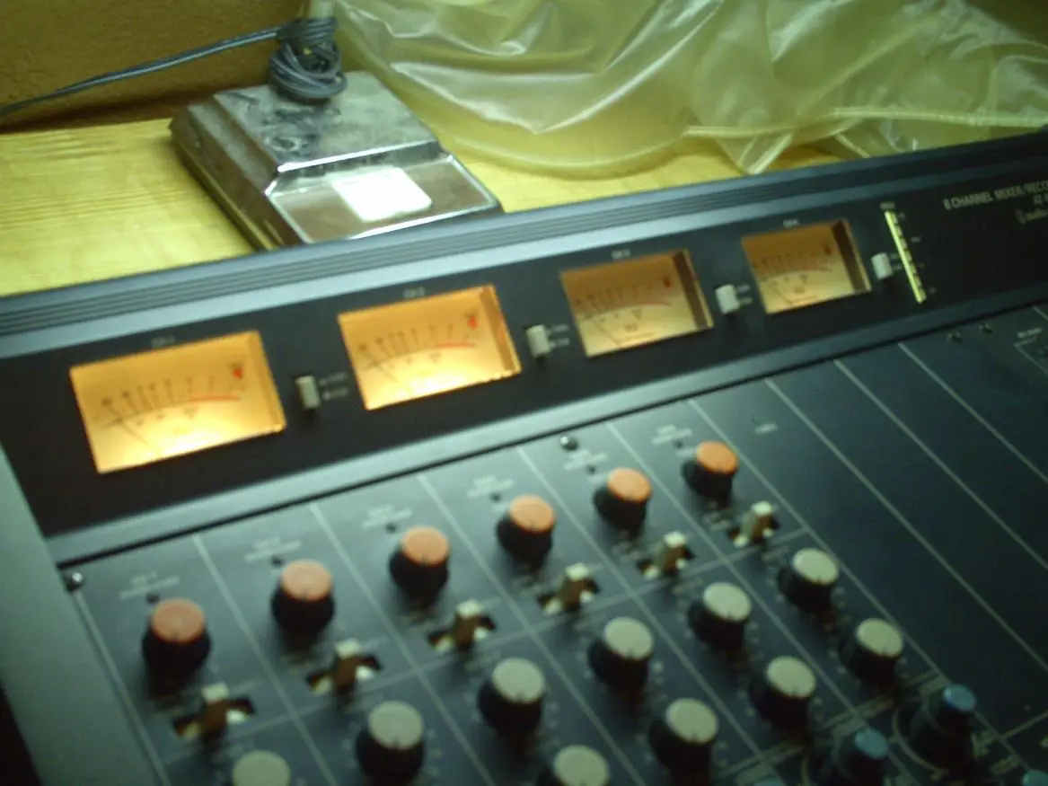

Interestingly, when I replaced the first bulb, it burned a bit brighter than ch. 3 and 4. I thought it was because my new bulbs weren't frosted and the old ones are. But I went ahead and replaced all 4 bulbs because I figured if CH. 1 and 2 were out, the other two were soon to follow. But CH. 1 and 2 still burned a bit brighter. Who knows?
