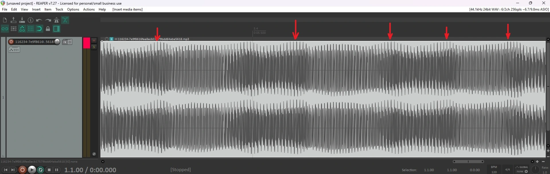

Here's the no-reverb .wav - - Looks and sounds like some clipping. Should this be the case, simply reduce the gain setting on the interface.

I don’t hear feedback - I hear clipping as @spantini has noted - looks like you have blown out the vocal.
I assume you had the pad engaged? That mic is capable of handling nearlu 160dB and that is mega loud! I suspect like others, you accidentally overcooked it.

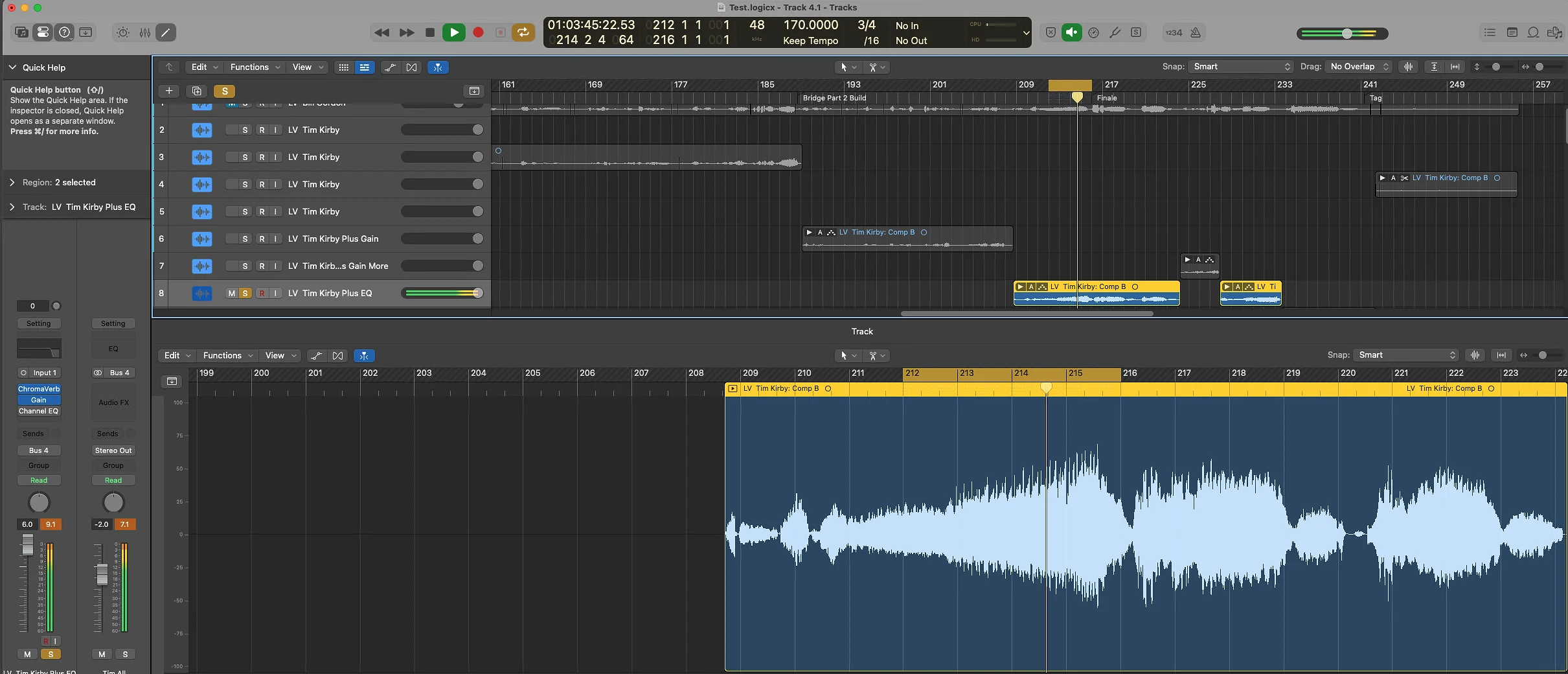

Thank you Papante and rob aylestone for your response. I did have the pad engaged, here is what I'm seeing in logic.
That picture of logic shows a track peaking at +9.1dB!! What do you think that is going to sound like?
You are recording 15-20dB too hot, to start with, or you’ve got some crazy FX going on.
Turn off EVERYTHING and start recording so your single track peaks are around -12dB before FX and then keep them there with whatever single track or vocal bus FX you’re using. Maybe they creep up a little, depending on how big the overall mix is, but if there’s a lot more going on, you’ll need to start low, or lower, and keep it there. For a non-accompanied vocal maybe -6dB, leaving some room for mastering.

keith.rogers, thank you. What I struggle with sometimes is getting the proper level for the vocalist to properly hear their voice. The gain plug is a bit of a crutch so I can increase the volume that they are hearing without increasing the input volume of their vocal signal via my Apogee Duet app. Good advice on the reverb on an Aux and using Sends to control, thank you. Will use all of your info on my next recording, which is happening today. New terf for me recording operatic voices, VERY powerful.
When the source is very loud, it can be difficult to get the player/singer to hear themselves in headphones. You can always boost the headphone output at the interface, or use an external headphone amp, even a cheap Behringer, might give you more gain, without sending the mix into clipping/feedback territory.
If you are turning the headphone volume up so the singer can hear themselves over their own voice inside a vocal booth, I would not be surprised if the headphone output is being picked up by the microphone.
You have to keep levels below 0dB inside the DAW because that is operating on a digital signal, at least unless you have verified you're DAW and interface is using 32-bit float all the way through, including all plugins. Once you get to an analog output, like the headphones [amp], you can twist that [volume] knob until you reach unacceptable distortion in the amplifier.
. . . The gain plug is a bit of a crutch so I can increase the volume that they are hearing without increasing the input volume of their vocal signal via my Apogee Duet app . . .
I see your headphones have the 62 Ohm impedance rating. This really shouldn't be a problem with volume with the Apogee Duet 3 @ .5 Ohm headphone out. If, however, you're using the Apogee Duet 2 with the 30 Ohm headphone out, the 62 Ohm headphones should still be loud enough but may benefit from a separate headphone amp to satisfy customers such as your current vocalist.
