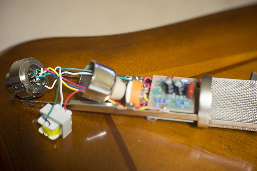

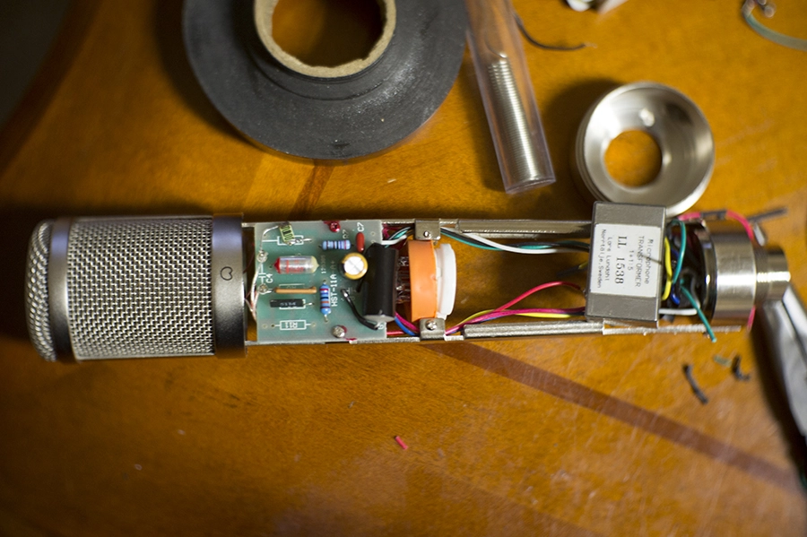

I think I found out the problem of my Apex 460. Last night I open up the 460 to replace the transformer with a Lundahl LL1538 and found that one of the wire on the old transformer was disconnected at the 9 pin XLR. The soldering works there does not look pretty at all, the wires seem like it able to short out too so I added some electrical tape. But after the transformer change, it seems to be working properly.
