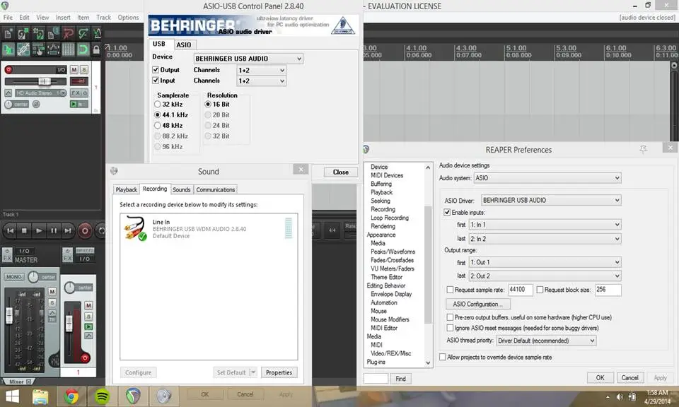

It is a Behringer UCA222. Installed drivers from Behringer website, selected the interface in preferences>Audio>devices>Audio System>ASIO>ASIO Driver --> Behringer USB Audio.
I don't know why choosing ASIO killed the sound before, but that issue seems to have disappeared. The AI is selected in the sound control panel.
The only activity in the track monitor is electrical hum from touching guitar strings while plugged in, but no actual sound (even checked that the guitar itself doesn't have a wiring issue...)
Here's a screen shot. Right side shows picking driver/device. Top left shows "ASIO configuration"from bottom right window. Bottom left just shows selecting device under the sound control panel.
Any more ideas are much appreciated! I refuse to give up on this...
The Windows pane (sic) shows the UCA 222 as a WDM device whereas the rest of Cubase lists it as ASIO.....Dunno but I have a UCA 202 and Cubases.
