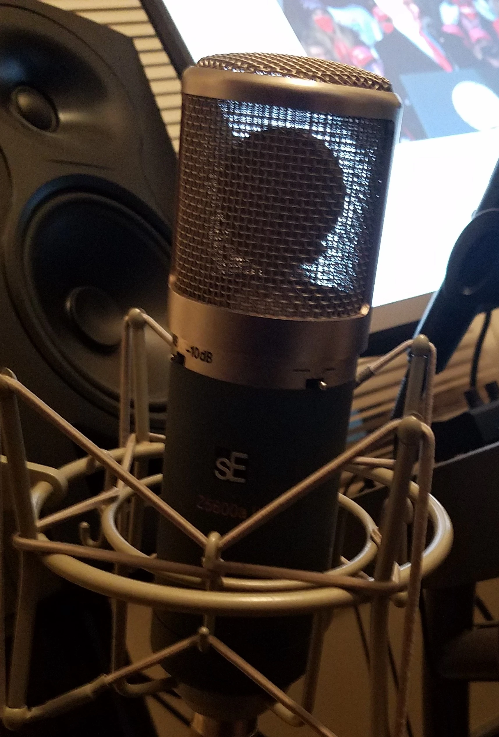

I feel like I got pretty lucky I found an sE z5600a MK II in mint condition for $475.00 on Ebay and it was also the newer model. The mic sells for a grand. So deals are out there if your patient. I also changed the tube which made it a bit smoother. Its basically a U47 clone. I love the mic.
