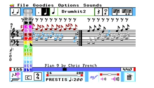

In 1988 I had an Apple IIGS. There was a program called Music STudio Gold 2.0. It would be perfect for this.
DAW
