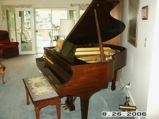

I may attempt to post one right here.
Thanks for a the info.
pic
Here is a scaled down pick of the baby

Good advice and info from dgatwood.
That piano looks pretty good, you might want to seriously consider picking it up. Very nice bench too, lovely. Really impossible to know for sure without playing it and hearing though. From the picture and your description it sounds like a possibility.
The Yamaha GA-1 is an entry level piano. But the Steinway is one of their smaller models as well. I do think the Steinway could be a step up. It really depends on the instruments. You have to play them, or your daughter has to play both. It's *impossible* to know without playing them, like with a violin or any other instrument.
Of great importance is the pin block, which is what the pins sit in and is what holds the tuning. If that is in good shape then tuning should be okay. It's pretty normal for some strings to go out of tune before others. If they go out of tune immediately after tuning that can be indicative of a problem though.
As far as rebuilding a piano, that's a big job and they would do it at their shop, not in your shop. If you just want new hammers and whippens, they can take the action out and take that to their shop. After they've finished they bring it back to your home and put the action back in the piano. It usually requires some follow up visits to make adjustments.
That piano looks to be in really good shape, based on what I can see in the picture. I personally would not have it stripped and refinished, unless it looks significantly less good in person. It's possible the only work you'll need to do on it is replacing the hammers and other parts of the action, and possibly size up some of the pins if they are slipping. That much should not involve a trip to the shop for the whole piano, just the action should travel.
To make it perfect cosmetically, flawless and all that, then yes it would have to be put in the shop and completely restored. But for a piano that will look fine in a home and be used for playing and practicing, it looks pretty good as is. Certainly a lot better than my 1922 Steinway Model "O", and I'm a professional pianist! Mine is a beater cosmetically but plays well, it's been in the family since my great grand-parents bought it new. I'm the fourth generation to play it, although none before me in my family were professional musicians. I wish the case of my piano looked that good!

I don't know if but I think I stated this. But now that I have a group here I'll repeat it.
My Daughter is a very talented girl actually a piano major at Bob Jones who reads music like a robot, I think see got it from here Mom.
Any way see played the piano at the home it is located in which is in a large room with carpet and 15' ceilings. She thought it played great and sounded
richer in tone than her Yahmaha. But it was not as loud and did not have the
trebles of the yahama "goes along with what Albert was saying"
But her yahmaha is in a smaller living room with a bare hard wood floor and
miminal furniture. I'm sure it wood be louder if it was in her living room.
Any way the appraisers evaluation stated that the piano is in very good conditional considering its age. But also that the sound board has very little crown almost flat. But that the sound board has no cracks. He also stated that the bridge in excellent condition and the strings are in average condition.
He also mentioned that the action has vertidegrees. He appraised its value as is being $7700.
What exactley is vertidegrees to me it sounds like the action is loose enough that the mechanisms are not standing completely verticle. Sound right?
She said there were no sticking keys and it played fine a little harder than her piano. She said the ivory was in excellent shape along with the cabinet.
She said the E below middle C made a little buzzing sometimes if you hit it hard but hitting soft seemed ok. It sounds like the hammer or a linkage problem there?
She also said the piano had a couple notes that were slightly out of tune and that it had been tuned in the last 3 or 4 months.
I did go to a piano forum in a tech section put to tell the truth I think I'm gett ing more info here than therel.
I'm seriously considering buying this piano and putting it in the larger room of my 2 room studio. If I do this I'll be forced to get rid of the 8' pool table taking up half the area. Then I'll do what ever it takes to make it play as it originally did. If my daughter wants it she will have time to sell her piano and it will be ready for its new home.
If she whats to keep her shiny new yamaha, then I'll sell my little Kohler & Campbell and be the worst piano player on the planet to own a Steinway.

Just for the record ..... I am a piano technician and was probably one of the busiest tuners anywhere. Thought that would have been clear with the 30 years of tuning thing but I guess it wasn't. I need to learn to be clearer. :)
The soundboard has lost most of it's crown huh? You might remember I mentioned that.
That is probably why you have that note that buzzes ..... when you lose the crown there isn't enough downforce on the bridge and some strings'll buzz. It's unlikely that it's related to the hammer or action although sometimes hammers can get so hard that they overdrive the strings creating distortion artifacts similar to when you overdrive a speaker. It's often described as a buzzy sound. In that case you would voice the hammers ..... but I bet it's related to the loss of crown.
There is no way I or anyone else can really tell you whether that piano's worth buying or not without actually looking at it .... and pulling that action out and giving it the once over.
I strongly suggest that you hire a tech to come over and really go thru it. There are absolutely things that could be wrong with it that you'll never notice no matter how much good advice you get because that's not your field.
I (and any good tech) can play a couple of chords on a piano and go right to many possible problems just from hearing various sounds that we've come to know represent certain issues. You would never hear the kinds of things I'm talking about.
I'm not saying the piano has any problems but for that much money I'd have it checked out first.
I would charge someone 50-60 bucks to go thru a piano .... I imagine costs will be somewhere around that.
Oh ..... and I haven't heard that vertidegrees term before. But if there are parts of that action that aren't staying in their correct orientation .... that's even more reason to have a pro look it over.
LT Bob, now that sounds scary if its the lack of crown causing the buzzing.
But if that was the case wouldn't you get that same sound on atleast one other note? Remember it only does it when struck hard when she hit it at a normal level it sounded normal. I use to have an old upright that did that on alot of keys and the repair just put some new hammers on it and it was good to go. To me with my very basic play a couple bass notes with the left hand and a few chords with the right hand style I find I'm always in that area of the keyboard and it just seems like the most likely place for a hammer to get screwed up. But I know nothing about piano's and I have no ideal the how much arch needs to be on a soundboard. The only thing I would be able to relate it to is the soundboard of an acoustic which I guess also has a little arc even on a flat top unless it has become dryied out the top starts sinking.
If this is the case what are the options can it be reshape, zapped with some humidity and clamped in shape. I would hate to think what a piece of sitka spruce would cost big enough to do a piano :eek:
My daughter has the appraiser paperwork I'll see if his phone number is on it and give him a call before I go out and look at it.

Yes ..... it seems likely that it would show up elsewhere than just that one note. And yes ..... it can be a hammer. Over time as the hammers hit the string over and over it packs the felt tighter and tighter leading to those grooves you'll see on the hammer. It looks like the strings cut into the hammer but actually they pack the felt tighter making it harder. A reason that Yamis have a bright sound is that they come from the factory with hard hammers. They do this 'cause they want small children to get a big sound with a light touch. But sometimes they're too hard and the piano ends up being buzzy.
So it is certainly possible that it's just one hammer. But it is also possible that it isn't just that one string but that's the only one that's gotten bad enough to catch your attention. After all .... as a problem develops .... one note has to be the first one to get to that point.
Now .... I want to emphasize that I am NOT saying that's the problem and that you shouldn't buy it. But I am saying that with what you know ..... there's at least a possibility that it has a problem and that's why you should have someone check it out.
You can recrown a soundboard and it shouldn't be neccessary to replace it.
However ..... that's one of the only things I've never had call to do so I'm not sure of the procedure or what it costs. It's a pretty uncommon repair in the part of the country I'm from. Probably these concert tuners and rebuilders in New York or someplace like that do it but it's not something I've ever had to do. If it gets to the point where you really need to know about that I can call the guy who taught me ..... he's 90 but still kicking and even tuning sometimes although he's really lost his ear and probably shouldn't ..... but he would know about recrowning a soundboard.
