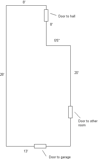

Hello,
I have an oddly shaped room and need to develop a plan. I will not be recording full drum kits often. I am trying to determine my needs for isolation. In the past I have recorded instruments and vocals one track at a time. So I have not yet needed to isolate each musician while they play simultaneously. I usually have recorded vocals after laying down other tracks.
I have uploaded the rough layout of the room. I am wondering about a couple of things. Do I need to put in walls for isolation? Can I utilize a Vocal Booth (VocalBooth.com) or a Whisper Room (WhisperRoom.com) for isolation instead? Where should I put my control room? Where should I place my DAW, board and studio monitors?
Does anyone have any ideas for what to do with this room?
I really appreciate your advice.

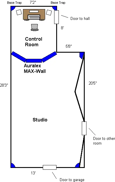

This is what I have been considering. I am frightened by what this could cost.
I know that I have done one things to avoid on the SAE website. I have no direct entrance into the Control Room.
Are there any other ways to eliminate the effect of parallel walls besides the construction of odd shaped rooms? Is stereo room symmetry around my speakers? Is it necessary on the back wall (i.e. behind my head?
Thanks for the help. I will also post some other ideas that I have.

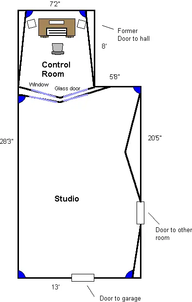

What do you think of this?
I have modified your design eliminating all parallel walls. I keep on standing in that room trying to visualize it. I just hope that the spaces are not too small. If I could I would mix while being suspended from a crane. I like open spaces. However, I think that this plan is more practical and less expensive than a crane.
I have not put it in the drawing, but the the walls would have accoustic foam and the tight corners will have foam base traps.
What do you think? Do you see anything that doesn't seem like a good idea? Are there any better ways of dealing with this space?
Thanks.
Lakin

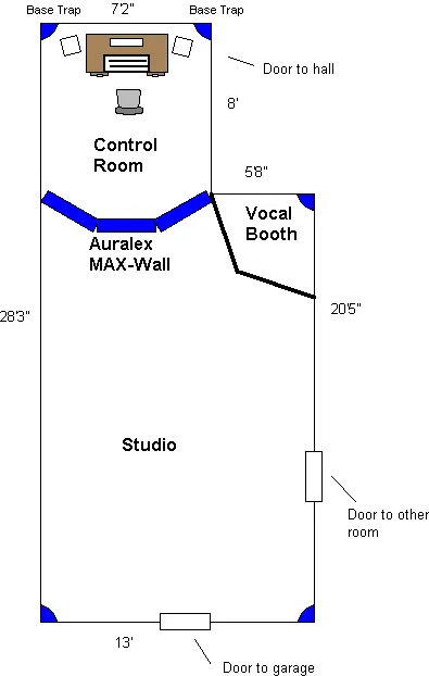

Another possible setup
Hello,
I have uploaded another possible setup. In this can I would use an Auralex MAX-Wall which is a moveable acoustic foam wall. I thought that this would be a good idea because I could use it behind me during editing and mixing on my Mac to minimize constructive interference and phase problems. Also I figured that the MAX-Wall could be used in the studio to create a more dead recording space. In other words I could put it around a drum set, guitar amp, etc.
This is my lower cost, maybe temporary, solution.
What do you think? Do you see any obvious problems? Will this be insufficient in the short term?
Lakin
Didn't you just say that you liked open space? That control room will be far too small. Try haning a blanked where the maxwall is in your latest plan. Then furniture the control room temporarily. Finally sit in the control room for 19 consecutive hours. If it feels OK, go for it, otherwise, try another design.

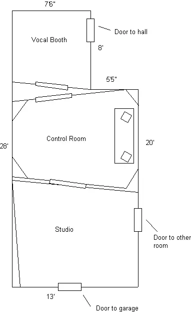

possible design
Hello Ola,
I am concerned that the space for the control room is small. However, I like the idea of the larger space in the studio. I was thinking that a larger space offered room to rehearse and jam with musicians as well as a good recording space.
I am, however, concerned about the number of parallel walls. This design eliminates some of the parallel walls. I have another design too that goes further. I will also upload that design. I am very concerned about the parallel walls in the control room. Am I excessively concerned with parallel walls?
Also do 90 degree angle corners cause acoustical problems? I just know from playing racket ball that 90 degree corners work like walls. I also remember that the acoustics in racket ball courts are terrible.
Lakin

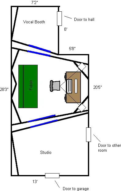

2nd design
Here is a variation on the former theme, but this one goes the further. It eliminates all parallel walls. It doesn't eliminate all right (i.e. 90 degree) angles. There is one.
I still somewhat concerned about the effect that odd shaped rooms have on resale value of the house. So I am really looking considerable gains in acoustics to be achieved if I put in a lot of walls.
What do you think?

I still think that your control room may be too small. Try th blanket and see how small it feels. it's easy to say that it's large enough when you have the open space behind your back. I like the idea of having a large studio room for jamming and recording but I'm conserned that your design makes for a too small control room.
The parallel-breaking walls in the studio may be a bit too angeled. Not that it hurts but it takes away more area than necessary. A 12 dergee angle is apparently sufficient to achieve a "non-parallel" effect.
As for being consernde with the resale value. I wouldn't build a studio in a house if I had any plans to move, ever.
Lakin - I think your "studiodesign12" is the best approach. I know you won't have as big a recording space but you will have a decent sized control room. It is a trade off but aside from the acoustic benefits, you also just have more room to operate, run cables, get behind stuff etc...
Just my $0.02 but if your looking for votes... this one gets mine.
Cheers
Kevin.
Thanks
thank you longsoughtfor and ola. I appreciate your 2 cents. I think that I also like studiodesign12 best.
I don't know if I will be here forever. However, I want an effective studio. I guess I will have to sell to a musician if I ever do or someone that like odd shaped rooms.
