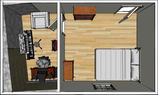

maybe do something like this...
create a absorder/resonator wall to reduce smooth response, trap bass and reduce flutter echo.... assuming your dimensions are correct....

Gullfo's picture is attractive, but I think a bit too ambitious for somebody still looking to upgrade from the stock dell speakers.
There are a couple of good points to it though, get your desk centered on the long axis of the room. Also turning one room into a well done recording room rather than trying to record in a bedroom.
But it is clear that both of those rooms are reverb hell.
So order a bale (two foot thick stack of two-by-four foot panels unfaced 703 fiberglass, You won't be able to buy less than full bales. Use some of it to build four four-inch-thick corner traps. Put two in the upper corners behind the speakers, and two in the upper corners on the opposite wall. You may need to put the one across the horizontal diagonal at the door corner rather than the vertical one. That leaves enough for four two-inch-thick absorbers. I would suspend one above the firstreflection point above the mixing position as a 'cloud' and two more on the first reflection points to the mixing position on the side walls. The last I would either put in the middle of the back wall or further back on one of the side doors depending on what helps best with slap echoes.
