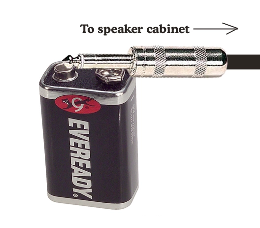

Well, you can now learn to troubleshoot. Start with the obvious; the cable, then the guitar. If that's OK, move onto the speaker. Grab the speaker lead, and put a 9-volt battery on it, thusly;
Just touch the battery to the 1/4" plug quickly, and you should hear a 'pop' from the speaker, and depending on which way you have the battery, the cone either pushes out or pulls in. If this seems OK, then it's not the speaker. Move on.
