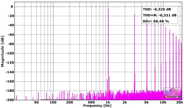

To illustrate my point, here's a plot of a signal showing quantization noise, harmonic distortion and aliasing effects. As you can see, the aliasing distortion shows up at multiple points in the spectrum despite originating above 20kHz.
Cheers :)
