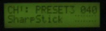

Step 3 - I have no display in upper left but I do have the channel selections on the lower left, so I hoped this was the CH1 you were talking about.
When I finished, the only thing that happened is that the mix was the last instrument I selected. Even though the display showed all the correct setting - hi and low notes, it played the same instrument on the whole keyboard. I also tried changing the second instrument to CH2 but that did not help.
It's possible that my QS is an older model than your (mine is ~1999 - 2000) so the displays may be different. I've attached a pictures of mine below showing the CH1 indicator referenced in step 3 and the button layout.
But even if yours is newer, I don't think this procedure would have changed too much. The bass program will go on Ch1 and the Organ will go on CH2. It sounds like you may be overwriting the bass program when you setup the organ
