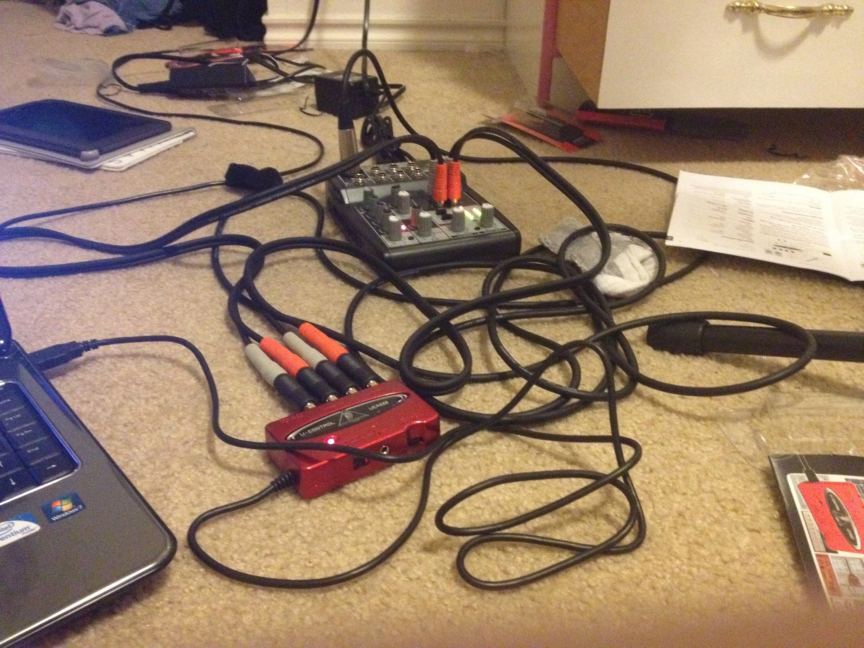

picture of everything

I see from your picture that you are feeding the 222 from the RCA outs. Logical I grant you but it really should be fed from the Main Mix outs. What you have should work but you will get some operational problems with that configuration later on.

The hookup D also shows the 222 fed from the RCA outs. This is wrong IMHO as the Main Mix out has a dedicated level control and operating the switch that puts MMix onto the monitoring bus could put clicks onto a recording. In any case, why have a Main mix out?
