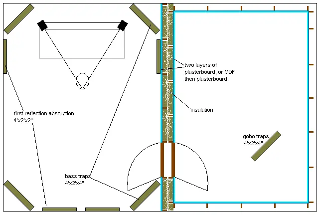

It could become a problem if you want to isolate, 'cause you're probably gonna have to raise the floor and lower the ceiling(build a room within a room). But, if you're small, like me(5'6), then it shouldn't matter.
No you shouldn't carpet any walls.
You should probably make your control room the bigger room, and have a 12'x8'(probably more like 11'x7' with the walls) booth. Or, at least half the space each(12'x9, and 11'x8').
This is what I'd do:
i might just raise the roof it can be done its just a major time consumer but im in no hurry.
Thx for the plan there pandamonk thats exactly what i needed.
