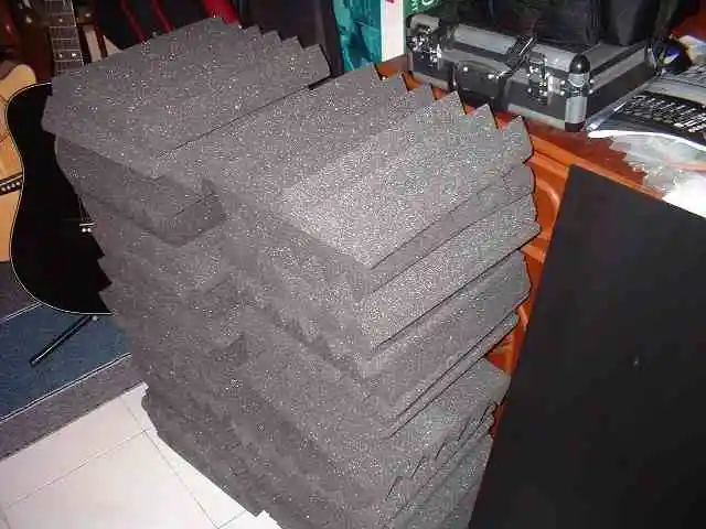

Here's my foams piling up at the studio till I figure things out. :)
If T-pins are what I think they are then I can not imagine that they are well suited for tazcking into concrete walls without bending in the middle and/or completely dulling the point.
