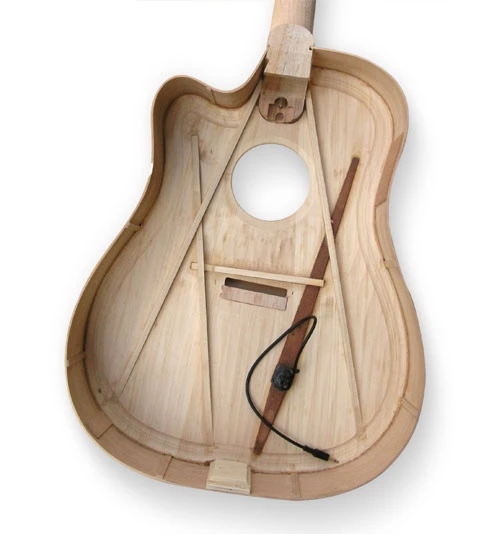

It would be interesting to look around inside with an inspection mirror. I'm not assuming this is a brace but... Apparently they have a "revolutionary" bracing system. Perhaps a brace is loose in the middle rather than at its end. You may not be able to find this by feel.
I found a picture of the guitars bracing. My focus would be on the darker brace and the pickup.
