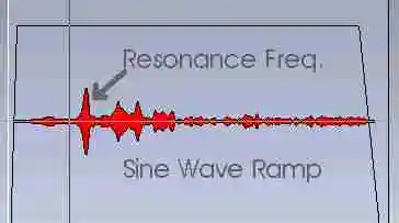

i tested the resonant frequency of the body and here's a graphic showing the problem. you can see the large resonance and some harmonics. i placed a mic inside the guitar body and swept a sine wave for external excitation. the guitar body really vibrates at certain frequencies as you can see.
i'm looking for a way to dampen this some. it may end up not being worth the hassle and i'll sell the guitar. if i apply pressure on the body, dampen it, the tones are much more even around the problem area.
