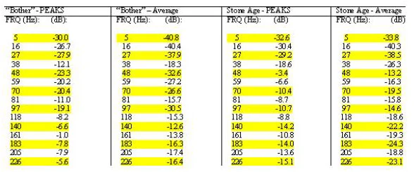

I'm curious how the bottom seems on some other speakers.. I know it's right at the threshold.. hopefully others will address that too so I can see what's average..
Hey Sam - first of all, nice job on the tune. The CPU line stuck out to me on the first listen in a good way.
Secondly, I'm used to hearing a lot of low end synth stuff in your tunes, so it doesn't really jump out at me anymore, but since you asked about "averages," I ran your tune through PAZ and compared it to something else that I knew had some low end synthy subharmonics in it. (I picked "Bother", by Stone Sour...you know, the lead singer from SlipKnot's "other" band, lol).
I don't know if you'll even be able to read this, but if you can, the first 2 columns are the "PEAK" and "AVERAGE" data from the commercial tune, and the next 2 column are the same for your tune. Looks like you do have some peaks around 50Hz that are about 20db louder than anything on the commercial cut, but I think the "average" data is more representative.

Hey Chris, that analyzer data looks really cool, what did you use to get that?
Could you use that data to figure out where to place your eq boost/cuts?
For example if you saw a frequency range that had avg. db lower than other surrounding frequencies would it makes sense to then apply a boost to that frequency (at the entire mix layer)?
p.s. Also if you record in 24 bit i guess you hear more clarity in the editor and then when you mix it down to a lower bit resolution you hear the "dithering"? But in this case then you won't know what you have at the 16 bit level until you actually mix down so it's kind of like a surprise?
It's been pretty handy for me lately, especially in trying to analyze the stuff that's hard to hear...like anything below 50Hz or (for me) above 10K.
It's just the PAZ analyzer in most WAVES packages. The interface shows the EQ curve in real time, so you can see any weird spikes as they happen...nothing more than my old fashioned stereo spectrum analzyer does, but this has 70 bands instead of 9, lol. Anyway, once you "Preview" a section of the tune...or the whole tune, just hit "save data" and it'll save a little text file of what's going on. Oh, and you run it in one of 2 modes..."RMS" or "PEAK"...peak is self explanatory, and RMS is like an overall average stereo energy of combined Left and Right over the range of the sample.
And yeah, you can use it like you were thinking...or more often, if you've got one band that's going nuts, bring it down to be closer to the surrounding bands...But then again, lol...it depends on the tune. Most industrial/techno stuff is gonna' have a lot more low energy and may not really have many spikes below 250, but most pop/rock tunes seem to have a spike at 63Hz and 120Hz, and maybe at 80Hz (for the kick), so the trick is to pick a tune that you think sounds LIKE the tune you're recording.
Oh, and on that PAZ analyzer tool, the thing I like the most about it is that you can run a commercial tune through it, see the EQ curve, SAVE the EQ curve, and use it as a background to compare your song with...I have about 20 EQ curves saved that I use as references...Mixes that I think are good based on having listened to them on a bunch of different systems...everything from Allison Krauss for the acoustic mixes to RadioHead.
I think Sam has the Waves package, so I don't think I did anything he hasn't done...it's just that I had that PAZ thing for a long time before I figured out that it could actually be useful, lol...so I thought maybe somebody else might learn something about it too.
