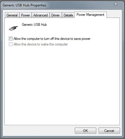

Sounds like your computer allows the USB ports to go to sleep.
Control Panel>Device Mgr>USB Hub> Power Mgmnt>Uncheck "Allow computer to turn off...."
Do this for all your USB hubs.

Pretty sure if you do what Chili suggested it will work perfectly...unless you are running a mac OS, which wasn't really specified in the OP.
Yes, I too am sure Chilli is right.
