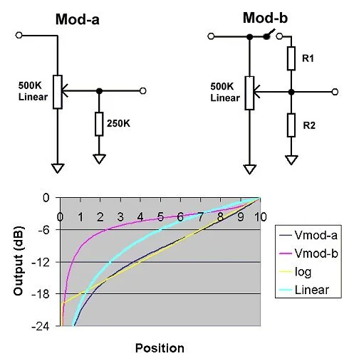

Is there a mod to switch between audio and linear pots? Like using a push-pull pot or something?
Lee
Here are a couple circuit modifications you can do that will give you the best of both worlds using a linear taper pot. The circuits and some the possible tapers compared to log and linear tapers are illustrated in the attached file.
Mod-a
This simply has a resistor tying the adjustment pole to ground. In this case I show a value of 250K or 1/2 the pot value. For the majority of travel it drops off like a log taper pot then becomes very sensitive like a linear taper at the lowest positions. Supposedly a resistor value of 1/10 the pot value most closely approximates an actual audio taper pot, but this will not give that initial high sensitivity.
Mod-b
This uses a switched resistor tying the input to the output. The Mod-b plot shows the switched in circuit with values R1=100K (1/5 the pot value) and R1=250K. When switched in the lower positions are very sensitive shooting the output up to -6dB in only a quarter turn - even more sensitive then linear taper. When switched out the taper is nearly log taper just like Mod-a. You can play with the resistor values to suit the sensitivity to your liking. The larger R1 gets the closer the switched in taper will look like that in the Mod-a circuit. R1=250K and R2=250K might also be a good combo. The switch could be either a separate toggle or a pull-pot.
The switch could also be bypassed altogether and R1 left hard wired. In this case R1=250K and R2=100K would give a nice combination of very sensitive low position and audio taper high position.
Try them all and see which one you like.
Hope this is useful. :)

barefoot - did you do these up? Or pick them up in your travels ?

Just made them up, though I'm sure it's been done before. I got the "R=1/10*pot for audio taper" from a remote level control circuit described in a Rane distribution amplifier manual. The curves are just from simple voltage divider formulas entered into an Excel spreadsheet.
Ohm's law and a bit of head scratching can get you very far.:)
