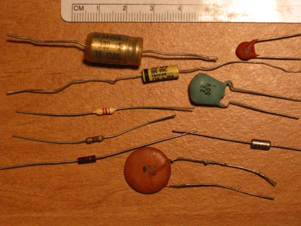

Thanks for all your help again...I really do appreciate it. I'm just a lowly college student trying to learn as much as I can before I really need to know it. And please excuse my utter lack of knowledge in the area of electronics...I'm just cutting my teeth. Anyway the pictures and descriptions are as follows:
In the first pic, the small redish round one says "x 5E, 120M, 1KV"
the large tan/orange one says ".01, 1KV"
the very large cilinder says "SPRAGUE, 30D, +, TE-1206,20-25 DC, 6447-L"
the small yellow cilinder says "CDE +/_ 10%, WMF 1D1, .001 MFD, 100VDC"
the large aqua one says "22, 50V"
and the small silver cylinder says "+NC1, 1K, +20V, 7414"
the other have stripes but no other markings...is there a table or chart where I can look these up?

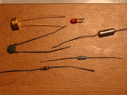

The second pic has the following:
the very small red one says "+ 6.1, + 35V"
the dark green one says ".05, +80, -20%"
the silver cylinder says "M39003/, 01 M, 2031- J, 213A +, 37942, 15VDC"
the small blue one that has stripes says "ITT" on the bottom

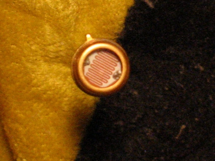

the gold one says "CL705L 331" along the lip and looks strange from the top
The third pic is a view of the gold one from the top (it's in an old pin cushion)
Capacitor ? value - possibly 120 pF
Cap, 0.01MF, rated at 1000volts
probably a cap, ?30MF, 20-25V
cap with noted ratings
cap, probably .022MF at 50 volts
probably a cap ? value
cap (tantalum) 6.1MF 35volts
.05MF cap
possibly an inductor - it seems to have too many stripes for a resistor
a photoresistor - like the ones that come in night lights that come on when it gets dark
http://www.acroname.com/howto/photoresistor/photoresistor.html
Thanks again! But how can I tell what type of caps they are (ceramic, electrolytic, film...etc)?
