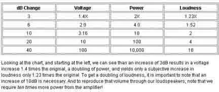

Re: Re: A familiar question
Ethan Winer said:
A change of 6 dB sounds about twice as loud (or half as loud).
That goes against everything I've ever read and seen published.
My references define an increase of +10dB is being perceived as 2x the apparent loudness. This is defined as an increase of 10 PHONS (+10dB-SPL).
[ edit ]
damn typos...
:D
There's seem to be some confusion on the 10db/6db thing and loudness. I don't know the exact answer but when you double the distance from the source the sound is perceived to drop by 6db. When you increase the sound by 10db you get a perceived doubling in volume.
Those two principles would seem to contradict each other and is probably part of the confusion.

BG,
> That goes against everything I've ever read and seen published. <
Okay, you could be right. I was just guessing. Of course, what sounds "about twice as loud" can vary from moment to moment and person to person. It probably also depends on the frequencies present.
