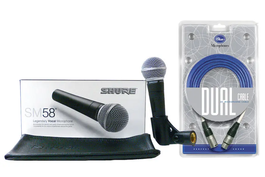

I attached a picture of the mic I was thinking of getting on Ebay. It comes with a XLR cable but I just still can't figure out how I would get that connected to my computer. I'm thinking I will also save up and buy a interface or possibly a stand alone unit like you use but in the mean time I'd like to practice with the mic if possible. And for that I need to know how to plug it into my computer. I have mic jacks that plug into my computer but I don't see how the XLR cable would plug into a mic jack so I think I'm missing something here.
Your question has already been answered in one of the replies one guy gave you... "convert from xlr to 1/8th inch "
What do you do when confronted with anything that doesn't exactly plug into something else..... buy an adaptor...
Alternatively there's probably a dedicated cable you can get.
or get an interface or a mixer and run from the stereo outs on the mixer to the 1/8th inch jack on the laptop
