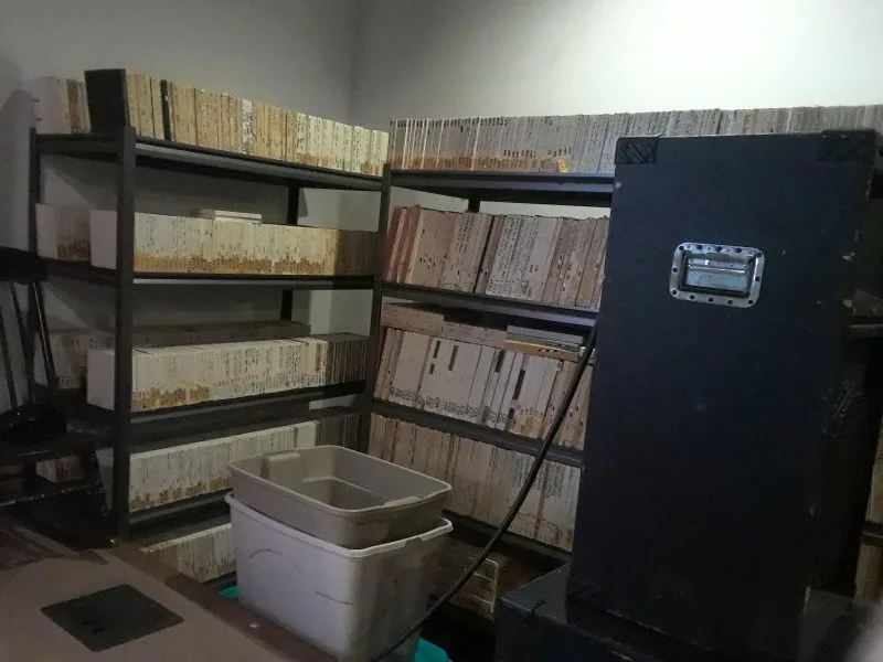

BTW, a while back I was in a local music store. The original owner was a musician from the late sixties who also worked with one of the studios that is long closed up. He managed to save the studio tapes that were destined for the trash heap, thereby saving a big portion of Louisville's music history.
Some of the music was used for a series on the local public broadcasting channel some years back. It brought back some memories.
