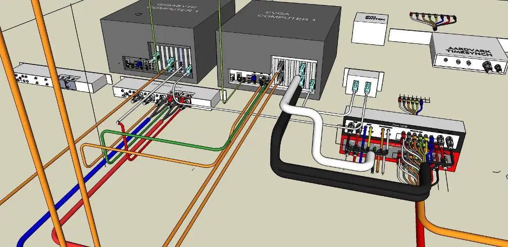

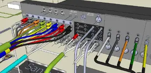

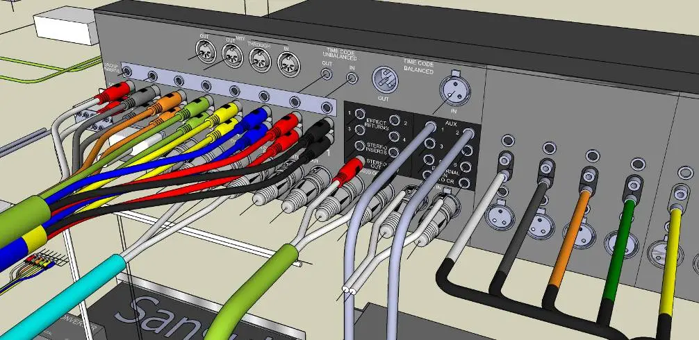

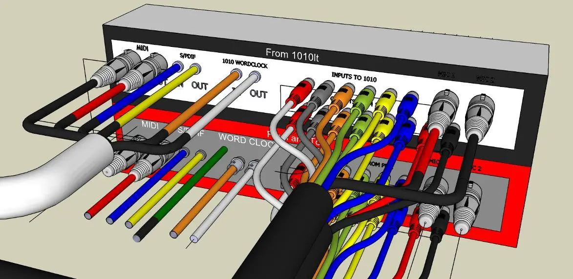

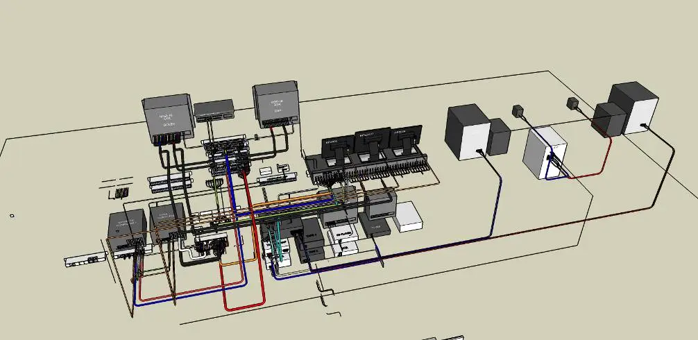

btw, speaking of mind f--k, had to layout the cabling system in Sketchup just to see where everything goes...just using a simple KISS technique. Can't even imagine what it would look like with the shield thing...gak! Besides..I haven't even finished the Sketchup, let alone the real wiring!
(note..trying to upload attatchments...prepare for Frustration attack:rolleyes:)
Anyway, thanks for all the info. It DOES help.

Already did all my soldering. 90% of my cables are DIY. It is the drawing that helped me identify where various sets of cables had to connect at each end in my console. Once the equipment was placed, then I could approximate the required length, so I don't have tons of "too long" cables coiled behind my console. Been there, done that...did I mention I hate cordballs:D In fact, it was my hatred of cordball messes over the years that dictated the drawing this way. I have 4 metal cable tie down tubes running the full length of the console at the rear to keep everything neat. Here is the console. It's still not finished, although I'm getting real close. Just have to finish the second computer mod and purchase a few goodies for it.
And btw, the furthest thing from the console that has to be connected is my twin MSR-16's, which are only 5' from the patchbays, and I have unbalanced 8 cable snakes. And actually, since I never have a need for sending more than the 8 buss outputs, I have another patchbay at the tape machine fixture, to patch to what ever tracks on each machine I need. The tape machines are synched via midiizer, so the tape returns are all connected to the tape in's at the mixer.

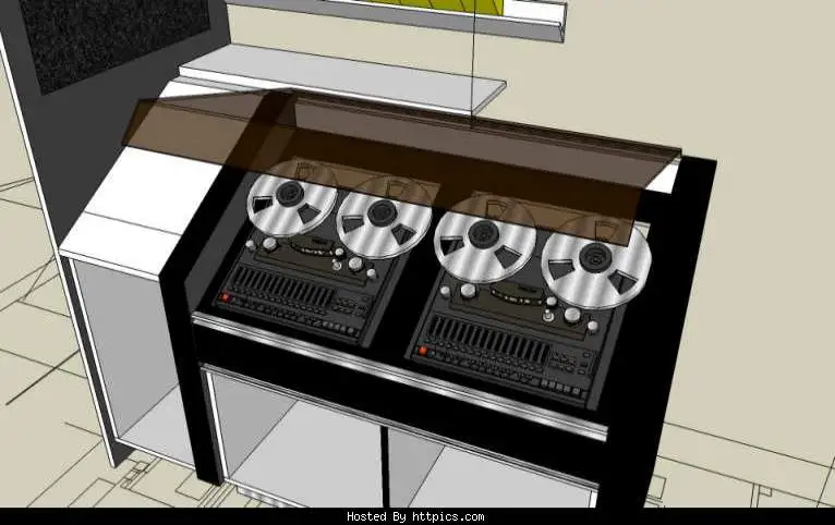

The tape return snakes are only 8' long so I don't think I need to adapt the technique you describe. The tape machine fixture in the Sketchup is already built, and sits to the right of the console within arms reach. Don't have a pic of it in that location though. The sketchup shows it in a machine closet at the rear of the room. That area now is being used for a diffuser.
It's only half built in the shop right now. And that's the problem with DIY. Too many projects..too little time.

If my cable runs looked half as good as those drawings.....
Well, actually, that was the whole point of drawing them..so the rear of my console DOES look that organized. Alas, I'm not there yet though.

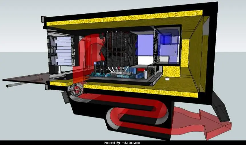

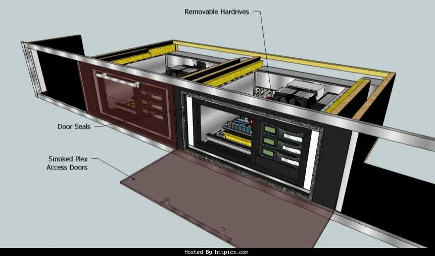

Thanks miroslav, Sketchup is a tool for me to visualize everything in my studio. It's called design. I couldn't have built a lot of the things in my studio without it, like the soffits the computer enclosure and various diffuser/absorption fixtures. Here's the enclosure.
My cabling is organized, neat and tidy, and everything labled....but in your sketches, it's all perfect! :D
Each run is straight as an arrow and square and everything has it's individual pathway with nothing touching...
...that's what I meant. Not sure if I could get them that perfect in real applications.
