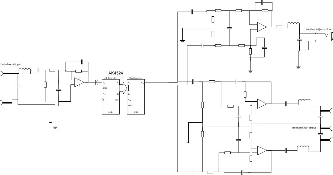

The staudio stuff is ment to be pro, it's consumer!
the input stages are done with TL082 opamps, one step higher then the opamp that is used in most of the consumer equipment
Then there is a little transformer in the microfon input, TOO little to work properly (ringing, low frequency respons etc.)
The line inputs are fed unbalanced into the A/D converter, the actual output of the D/A is balanced!! Then Hoontech decides to make it unbalanced again with more components.....
If I want to record live events, god knows what equipment is on stage, with hoontech there is a big datakabel, with adat (hammerfall) there is an optical connection so no risc for damaging my expensive computer and cards.
I attached a small drawing of the signal path (line-in and out) for one channel (channel 1 with un- and balanced output) within the hoontech interface also.

Nijbij said:
doesn't matter, I'm going to buy some Hammerfall stuff, at least that has quality
That's exactly what I'm doing. I'm so tired of the C-Port hassle. If it were stellar I might put up with it, but to my ears it's rather so-so. I'm loosing my C-Port and picking up a Multiface/PCI. See you on the other side. ;)
