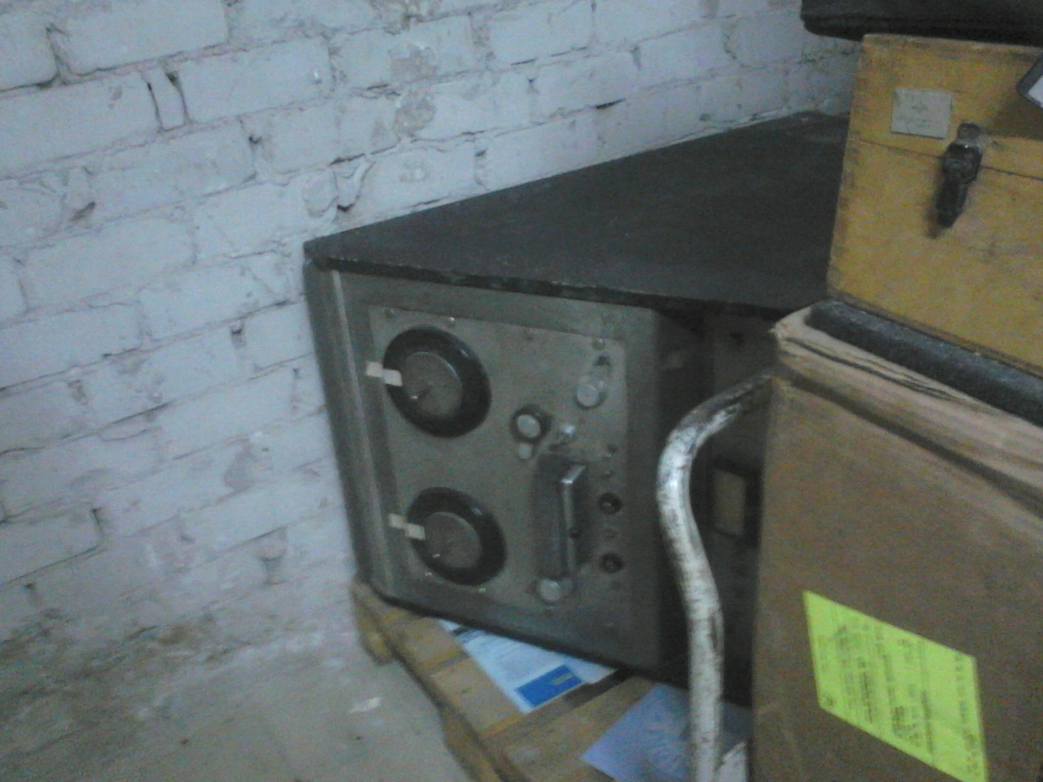

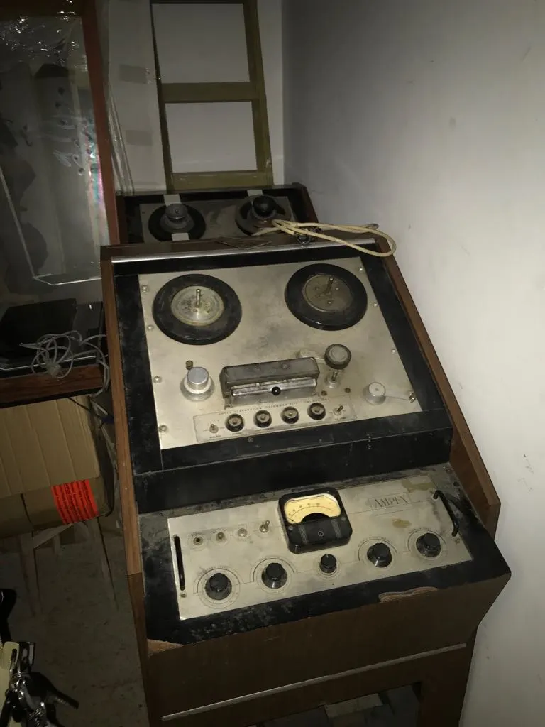

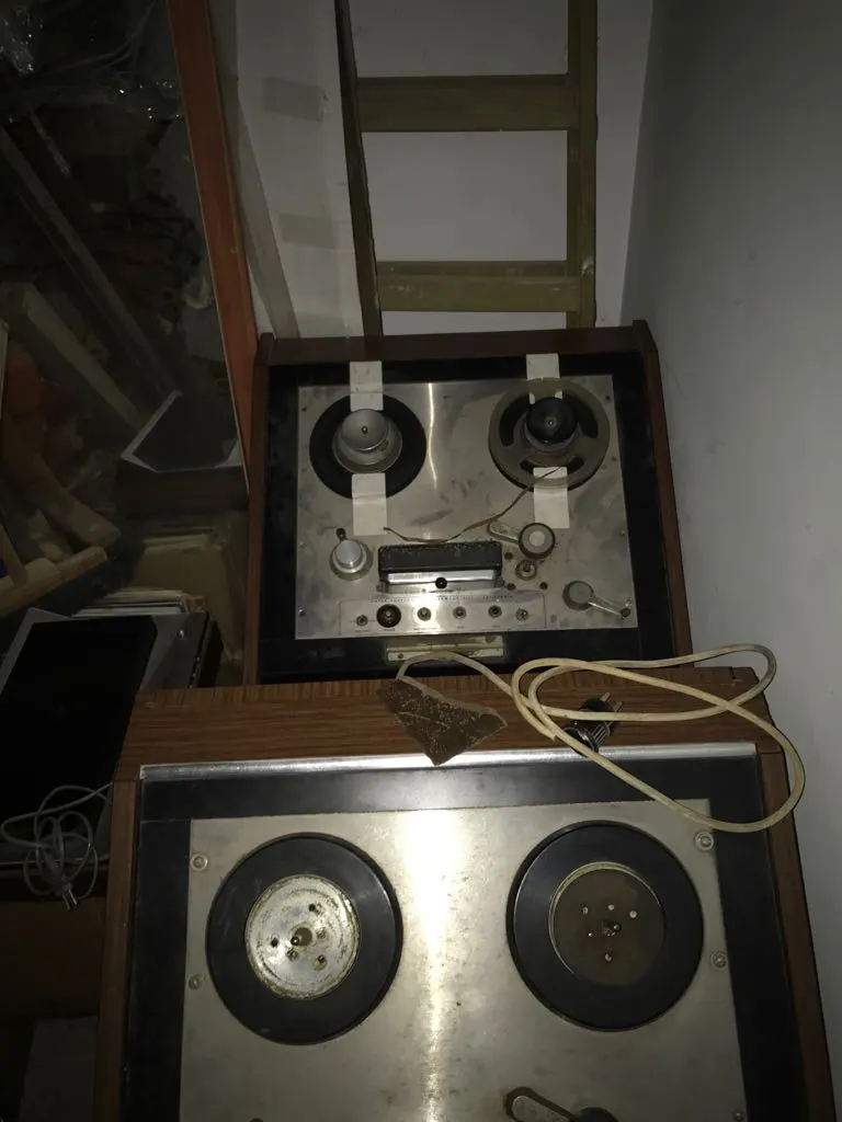

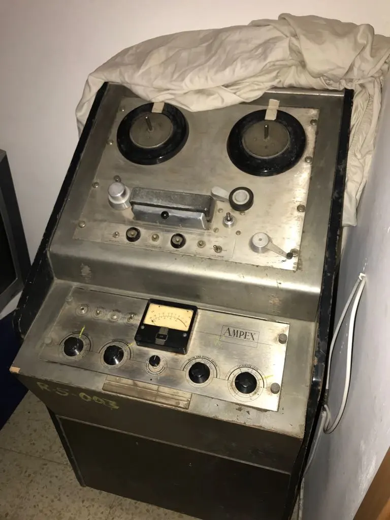

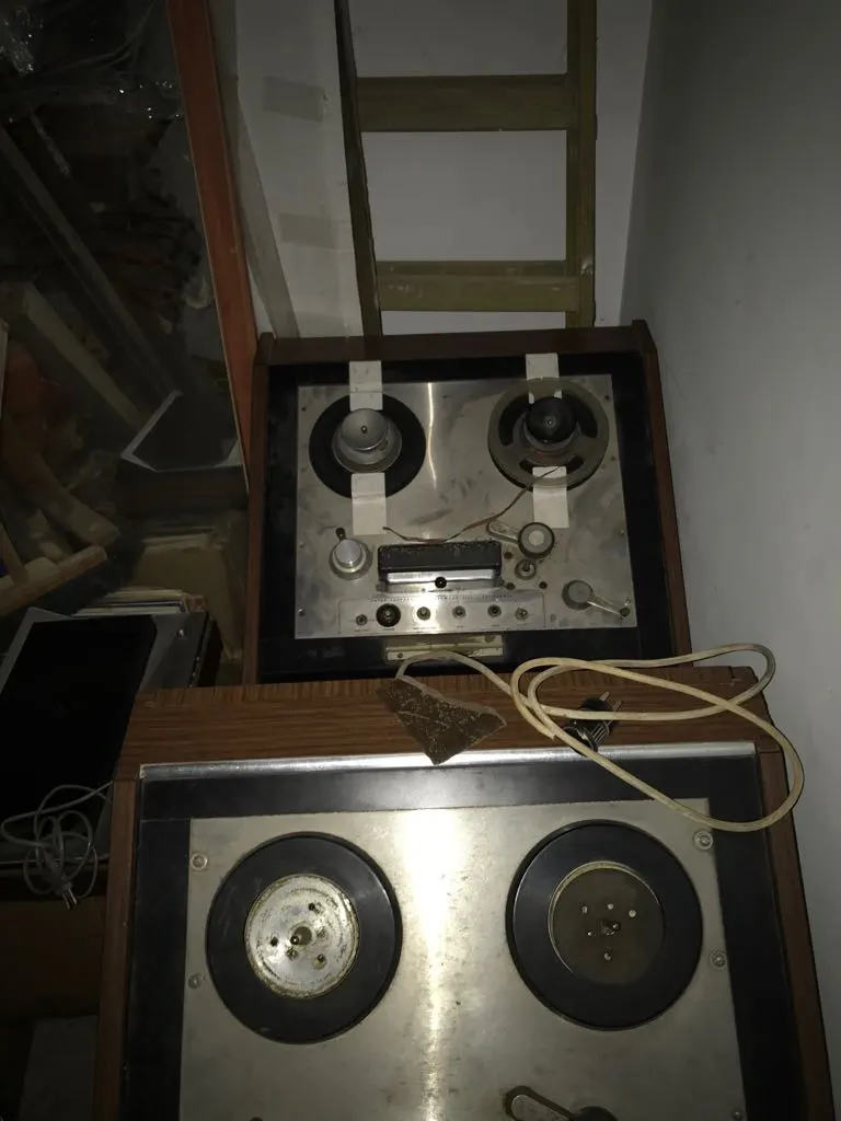

And here's the family:
WhatsApp Image 2018-01-03 at 17.06.41 (1).webpWhatsApp Image 2018-01-03 at 17.06.41 (2).webpWhatsApp Image 2018-01-03 at 17.06.41.webp
dirty, heavey, beaten up wooden cases, but generally good condition and ofcourse the beautiful amps are present ! atleast 3 of them. that means i can run at least a stereo machine and also the mono one.
Truth it, i think that this project gonna serve a good cause and i'm excited to have the honor to even touch those machines. getting even one of them to work is enough for me truthfully.

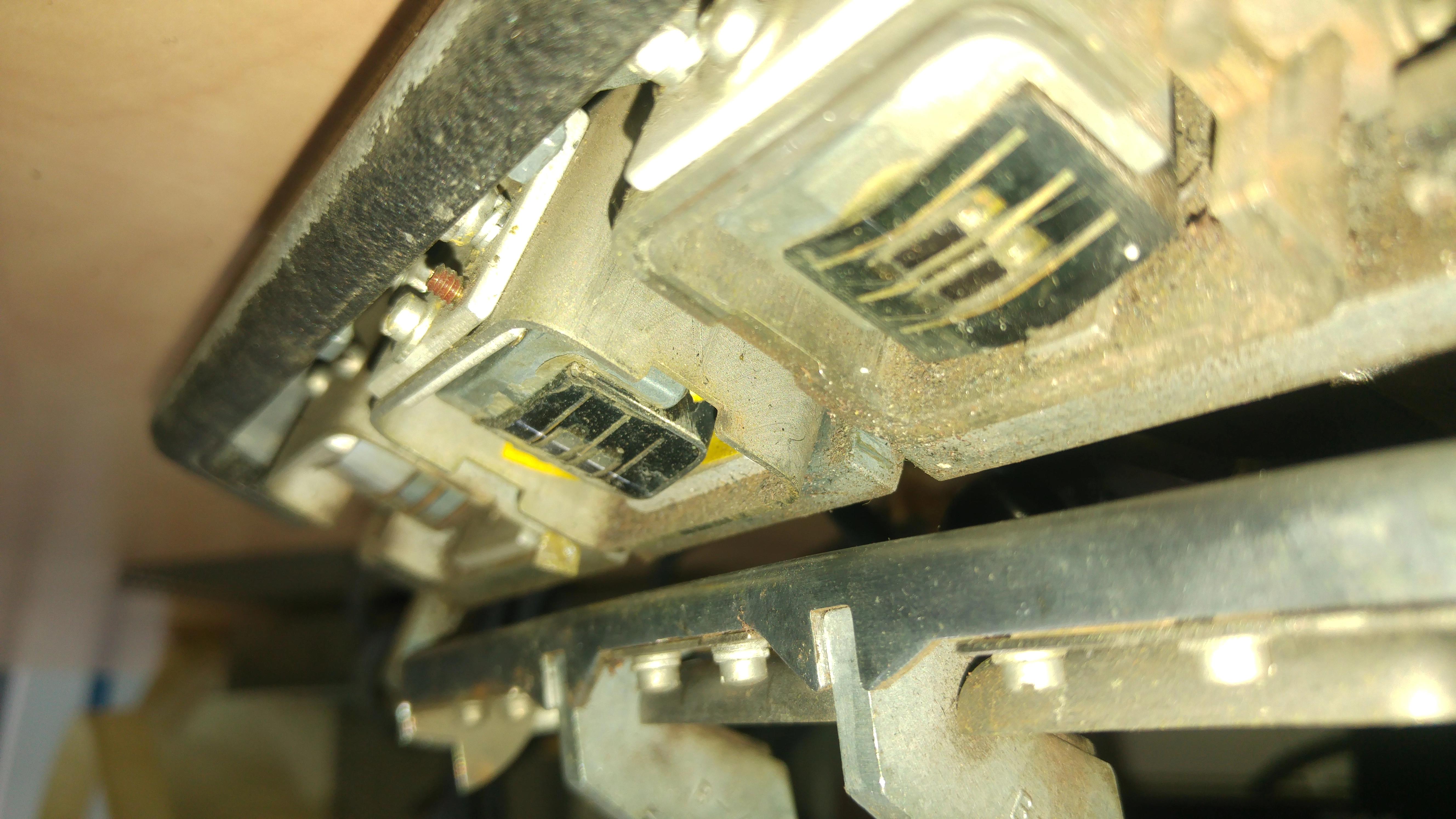

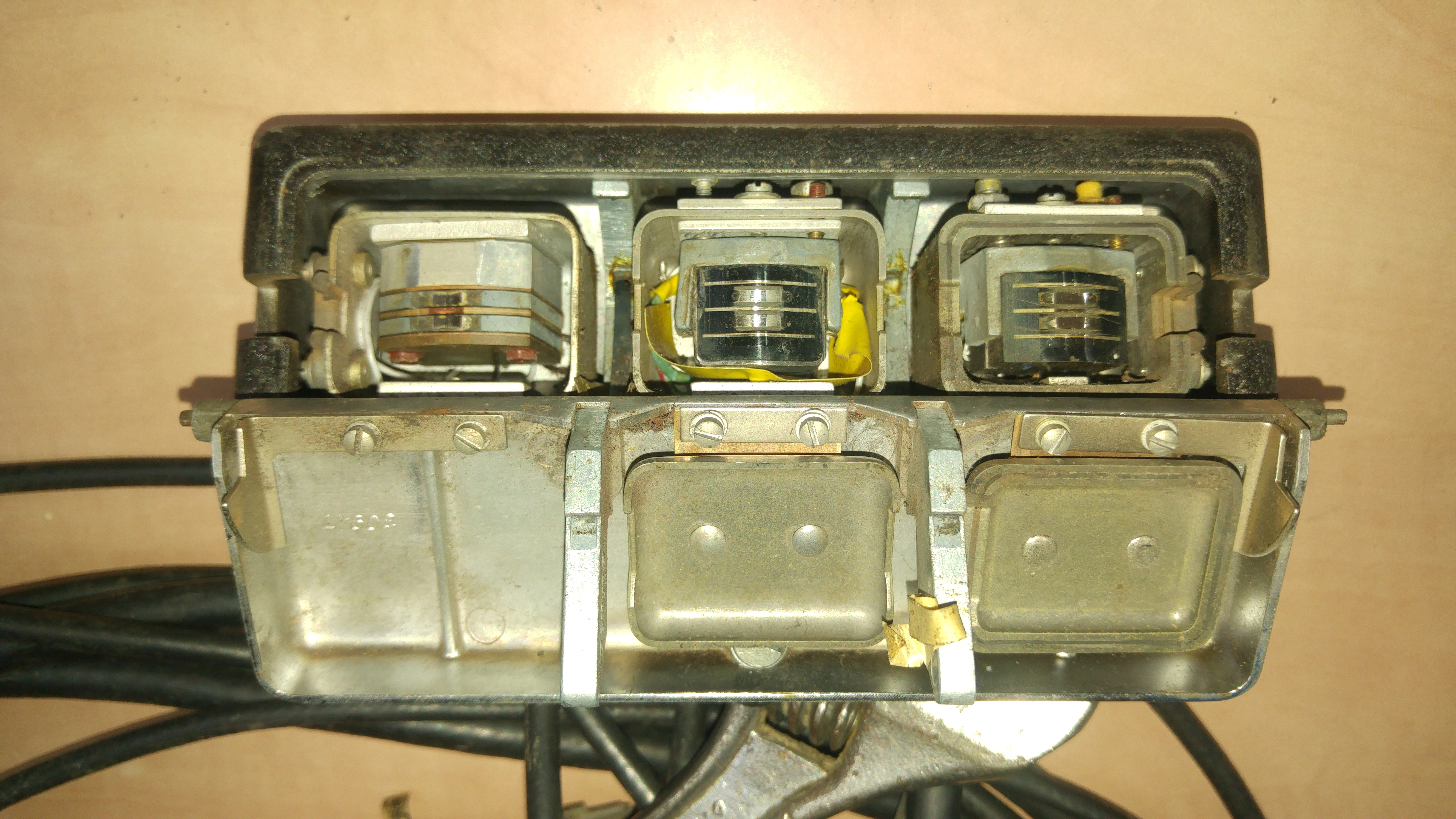

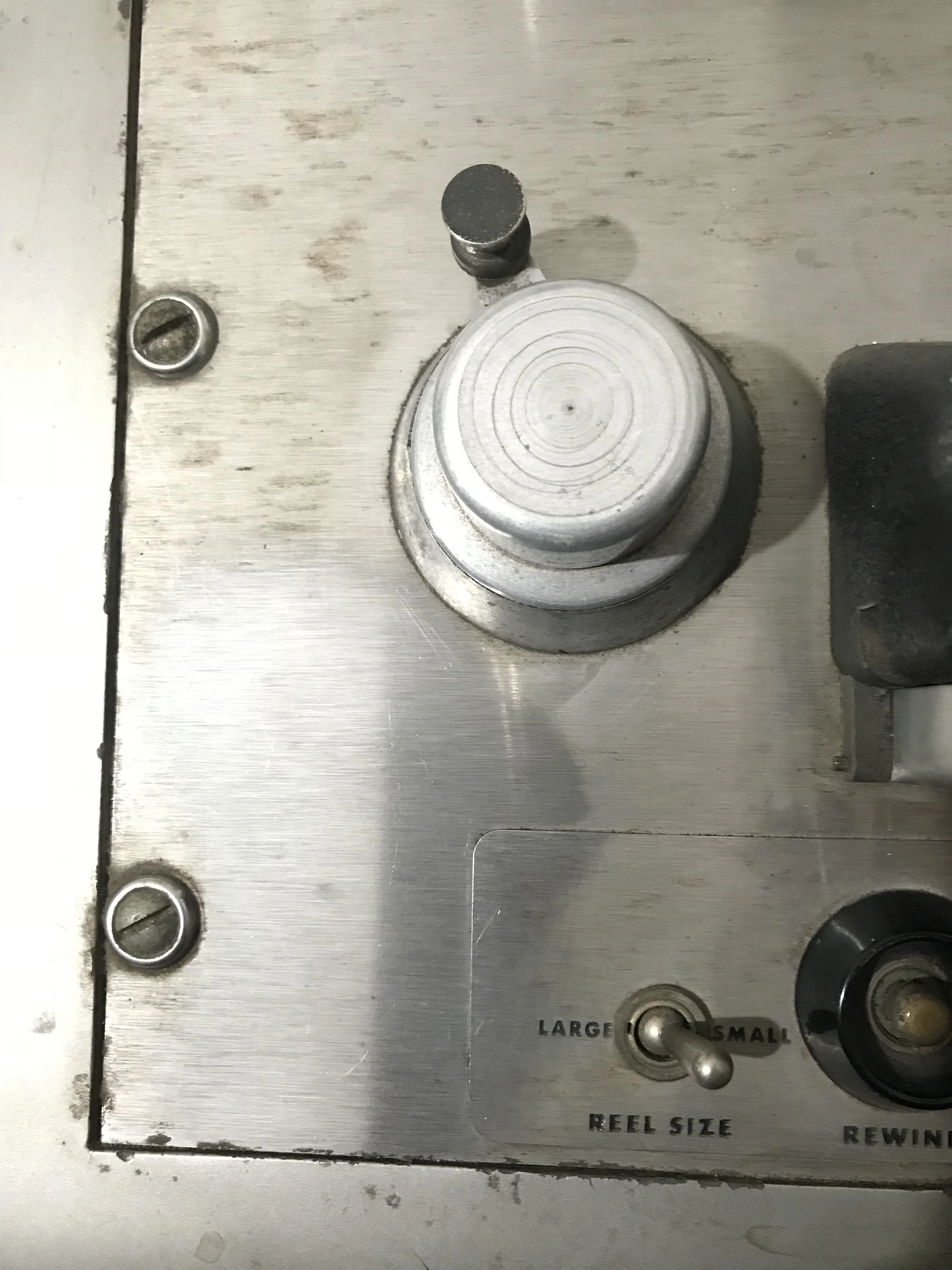

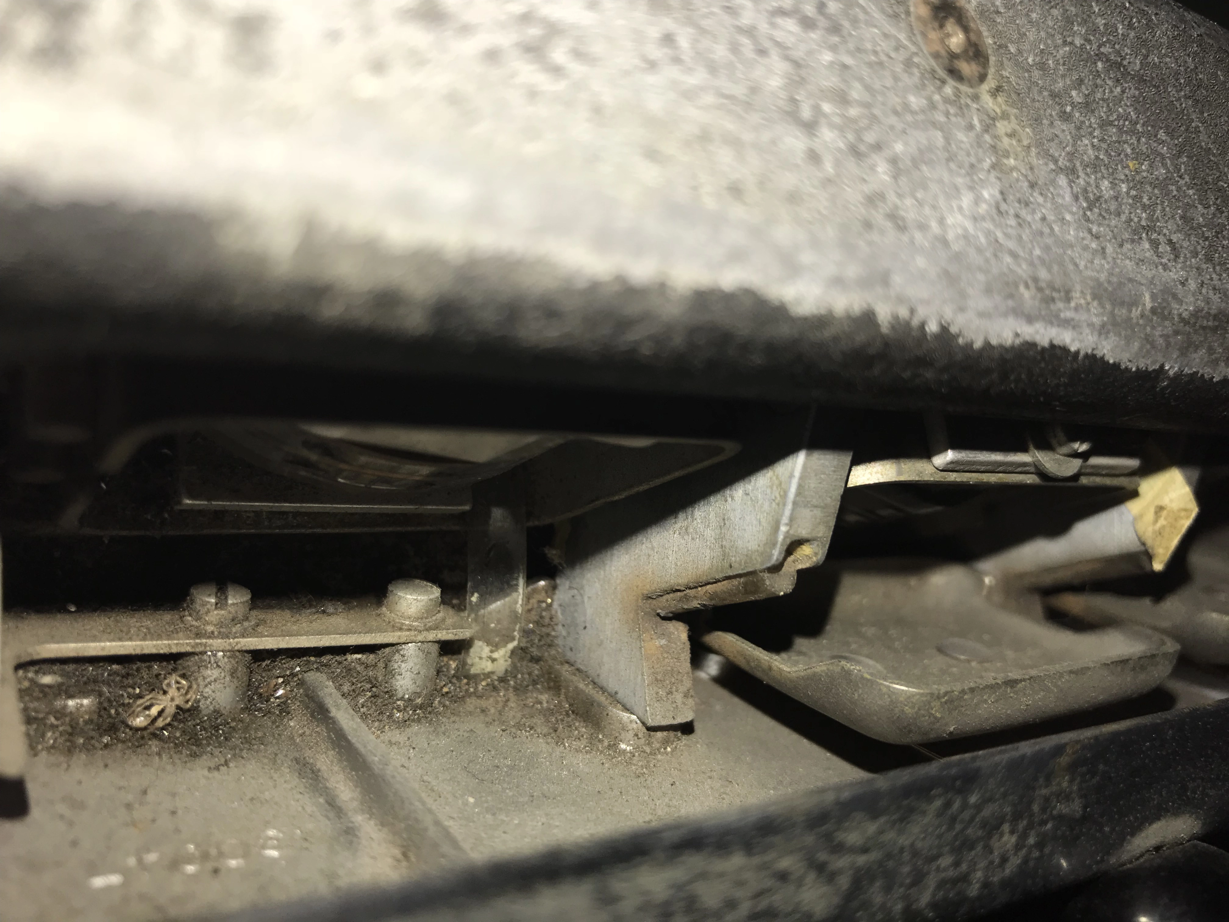

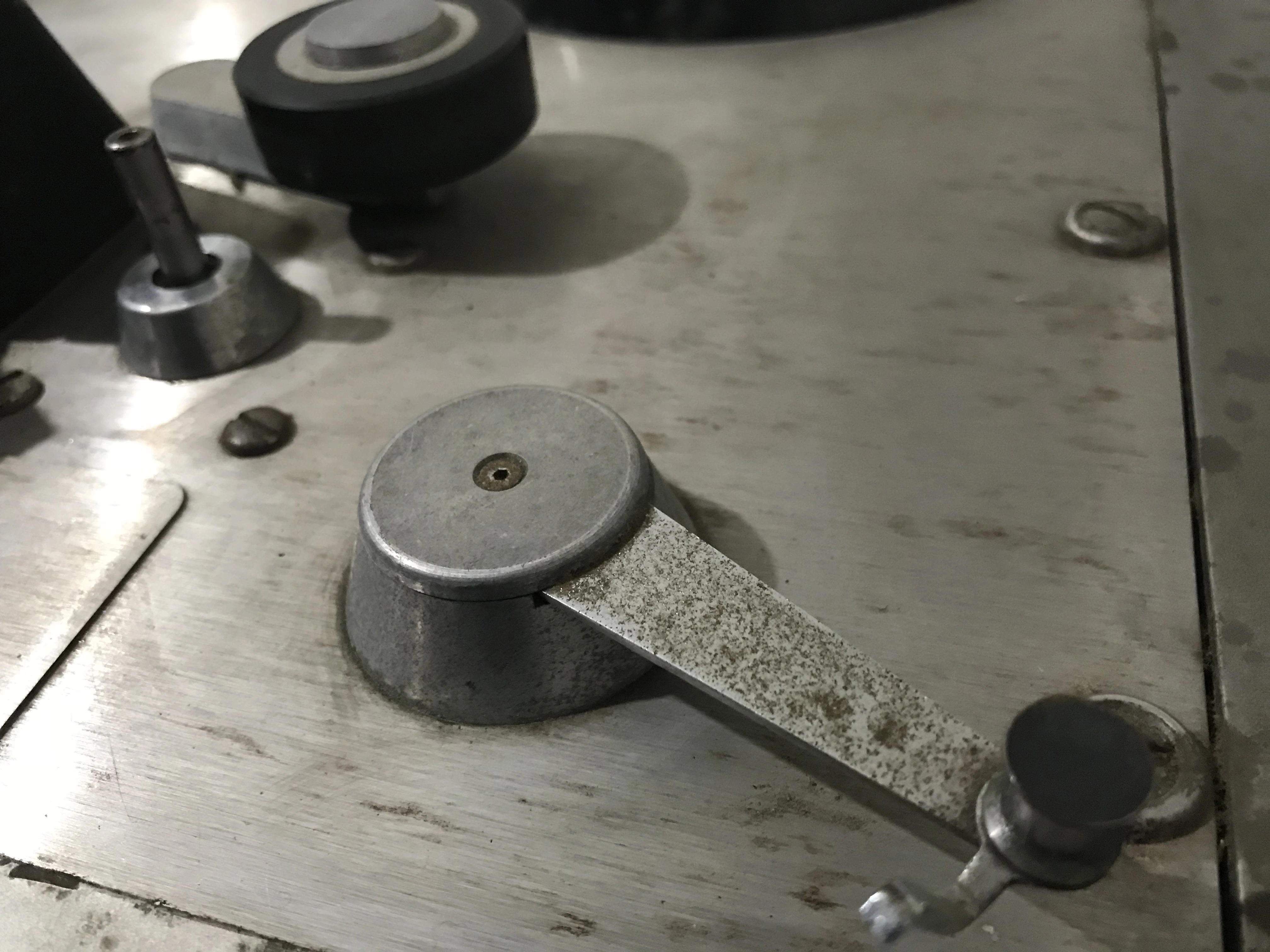

in the meanwhile, a photo i like to call "Erase head and a bug". also, some cleaning agent tests regarding getting that face plate all shiny again.IMG_2575.webpIMG_2569.webp
This is fun. :)
What did you use to clean the faceplate? I have lots of brushed stainless to polish eventually with my MM-1000.

sorry for the long delay..duo to the fact that it is my college studies final project it took a hell of lot more time then i thought to get start with it, April is actually the first month they are able to approve projects ideas. and so mine has been firmly approved and the two stereo machines transports made their way to the electronics lab at my school .
as for the polish sweetbeats, i used Peek multi-purpose paste for the test. it seems to do the job. Early next week i'm gonna take apart the whole transport and polish the faceplate to look like it's out of Redwood factory in 58' :cool:

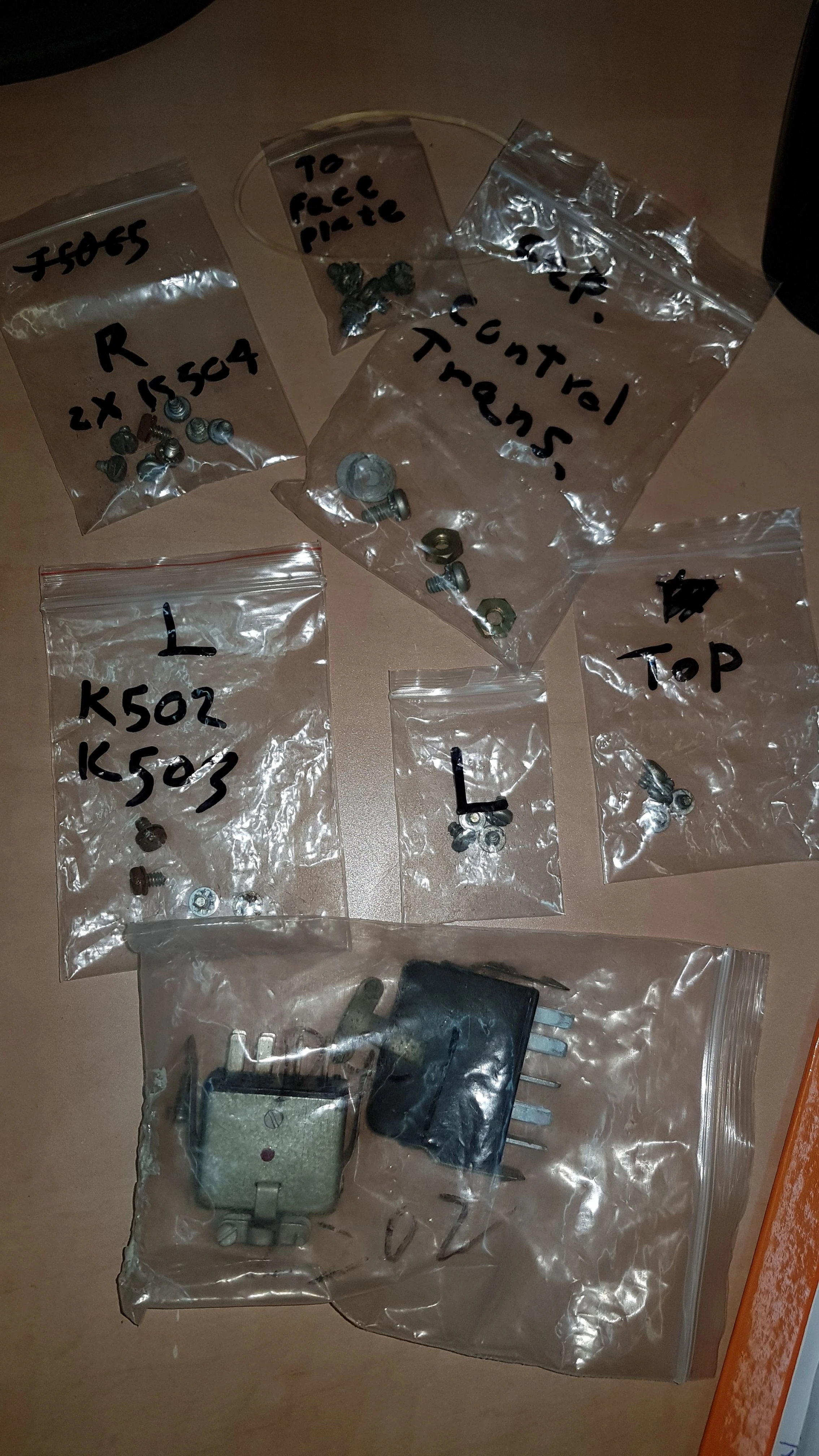

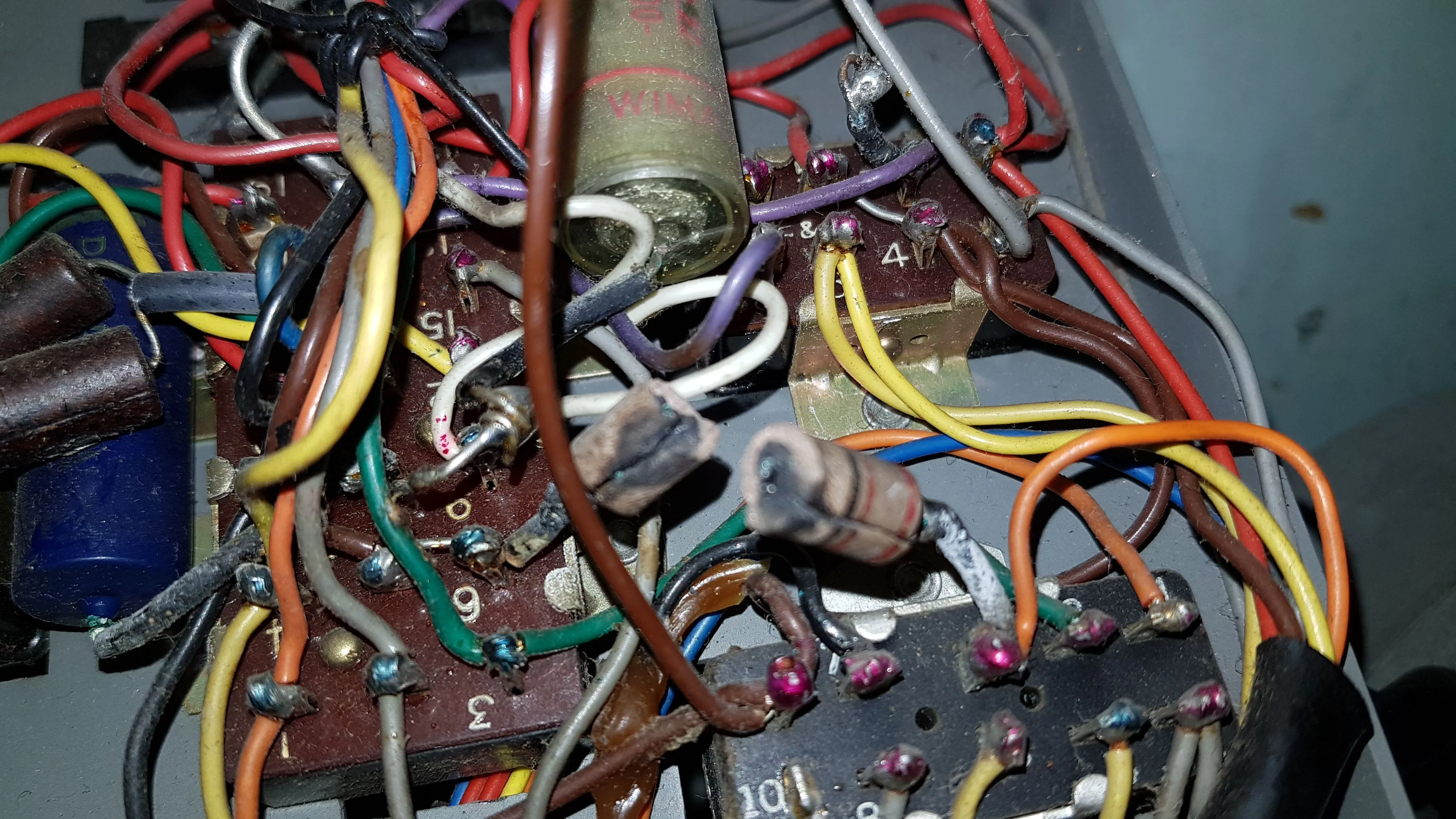

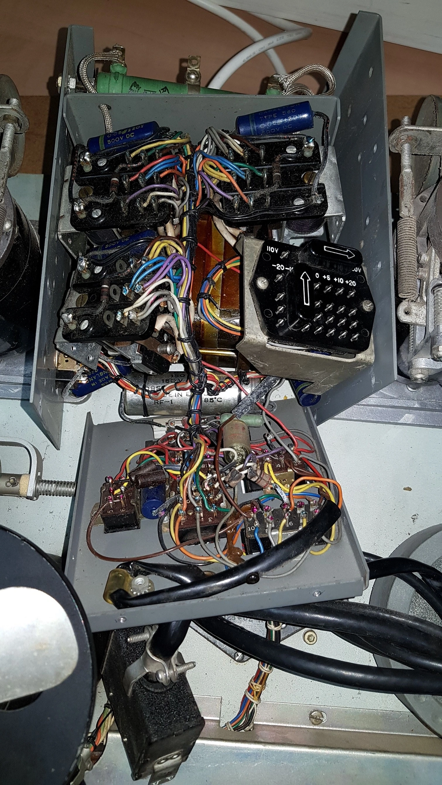

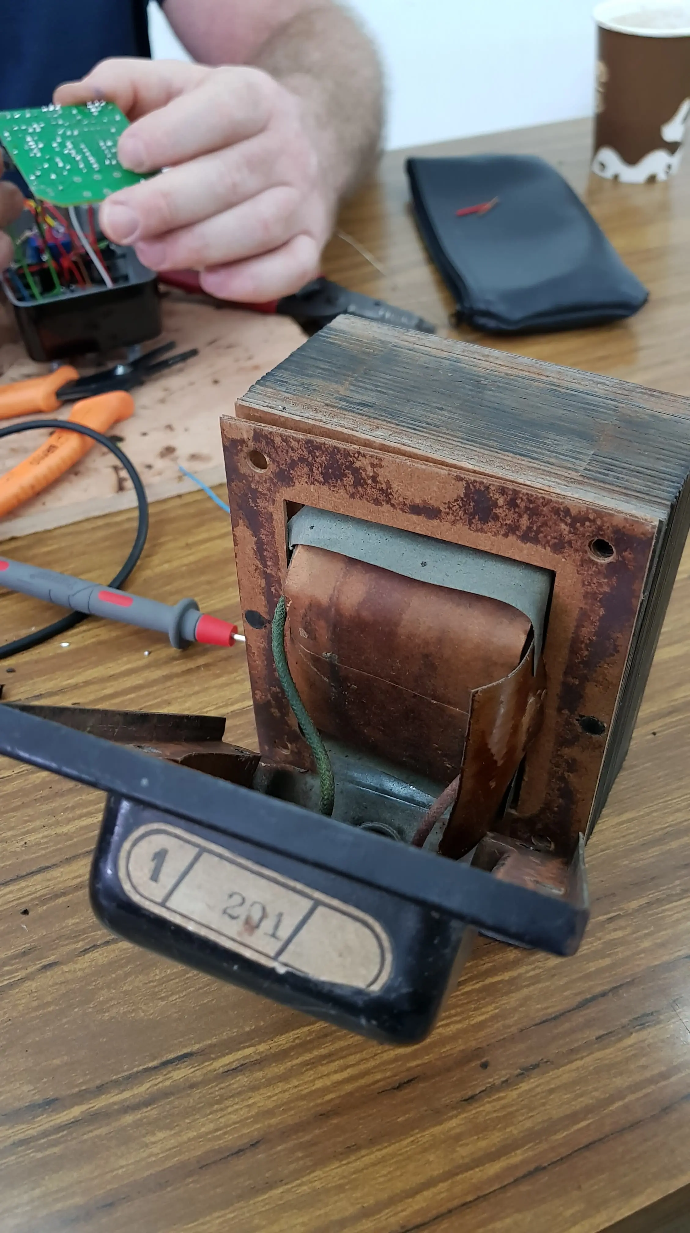

as for today, i have disassembley the "Control circuit box" as the manual states, and it is in remarkable condition according to my electronics teacher. i was quit weary at first duo to the fact that the machines were storaged in a house like 300 meters from the beach. no corrosion what so ever!
i was able to find tho a burned resistor (R506) bridging pin 5 of the remote control and pin 6 of the control section. (probably the remote control shorted out at some point). intresting to note, that the connector for the remote control is acting as a jumper and even if the remote is not in use, it is cruicial still.
in the photos:
- control circuit box dissassembled
- the late R506.
-some more close ups of the (first machine) transport

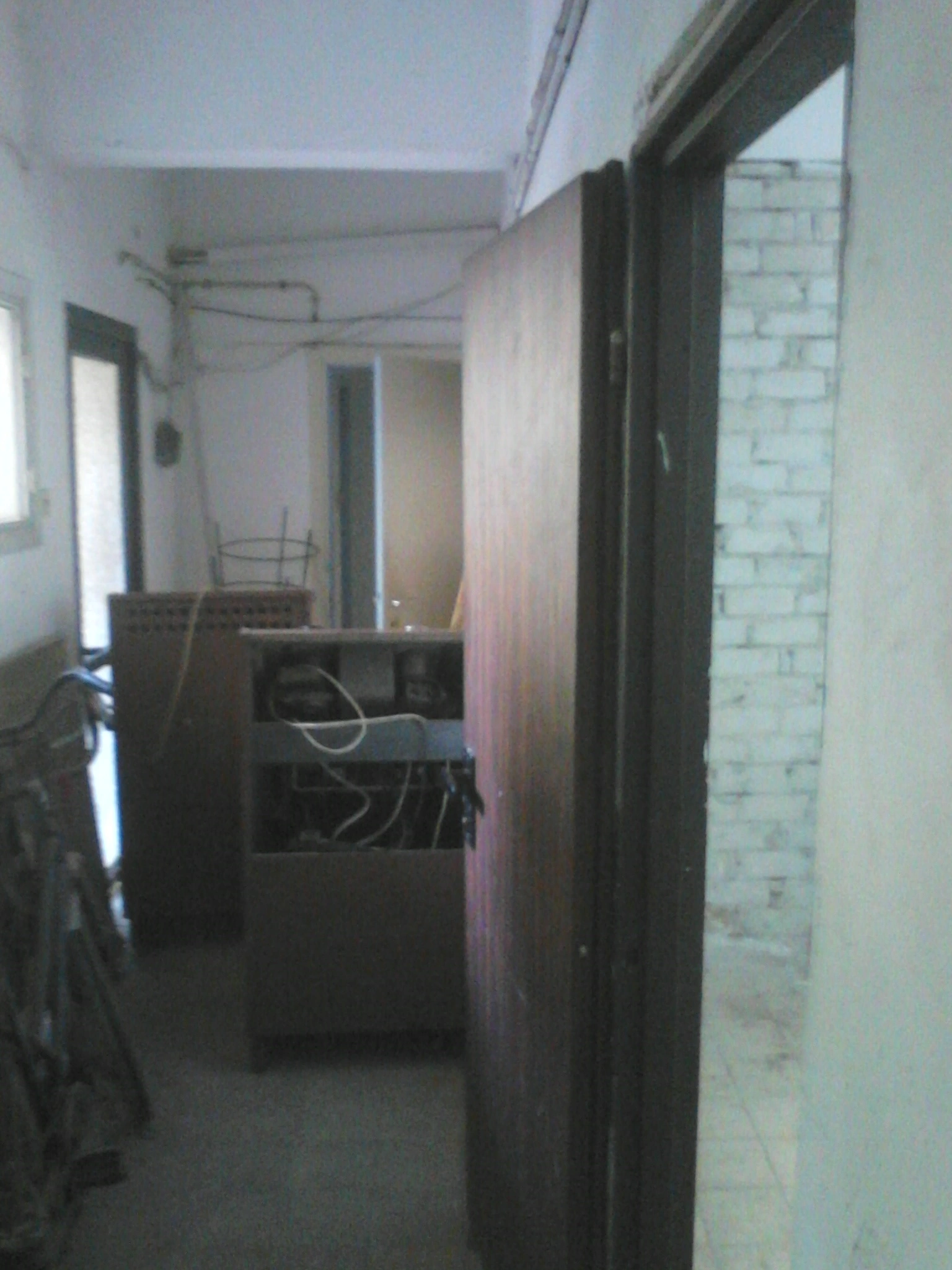

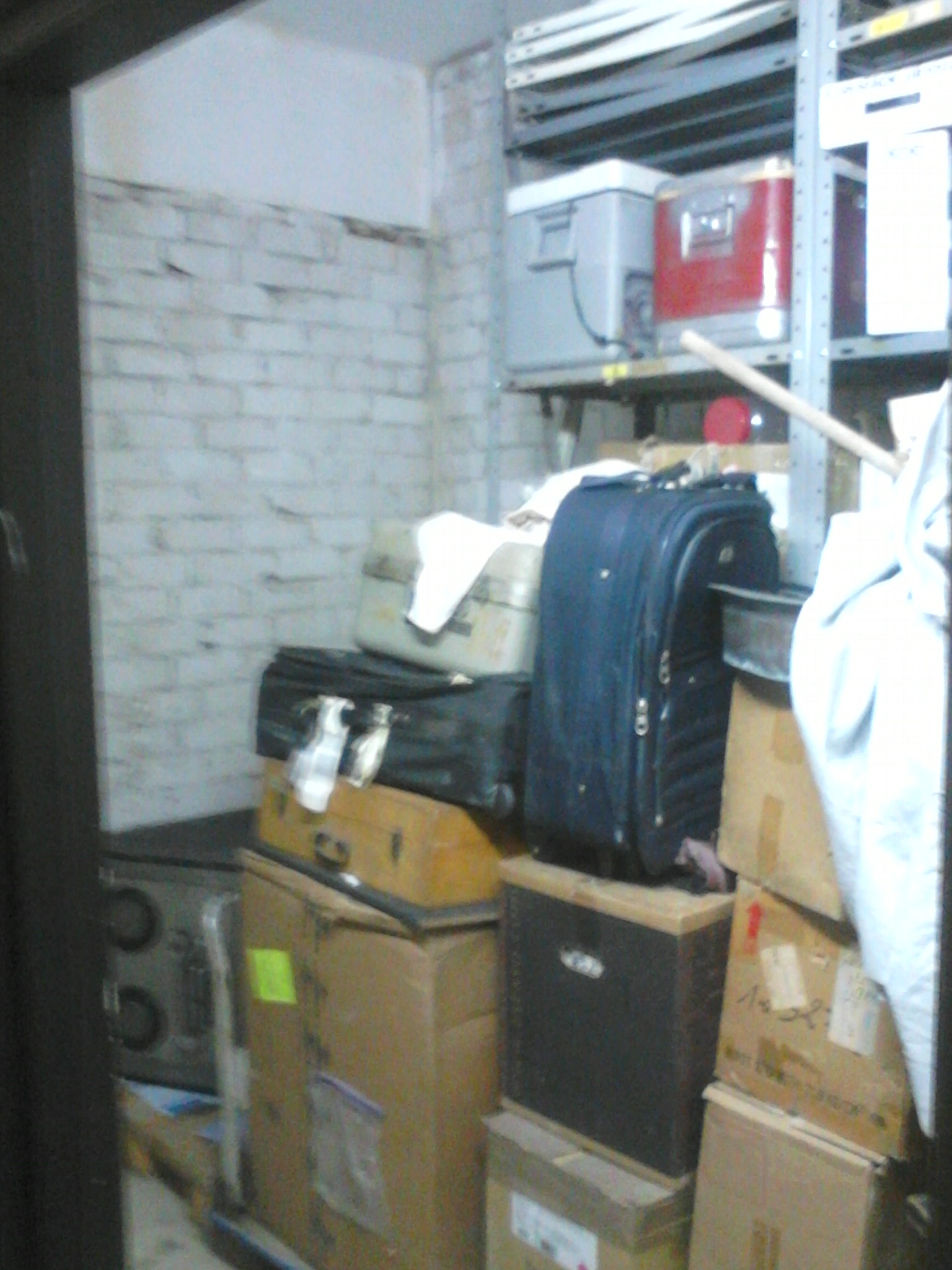

-and at last some more photos of that cold january salvage day
more updates soon!
Brave man! Don't know the machines of course but do have a bit of valve ken so might be of a little bit of help there.
Those conns' look like "Jones Plugs"? Takes me back the Church organ factory where dad was woodshop foreman!
Can I assume you are going to replace all those capacitors? The blue one look a little like 'our' Wimas (shorting ***t in Grundigs) and the black jobs Hunts? They are No 'King good either!

funny you have mentioned those blue caps..polypropylene caps if i am not mistaken, i have actually been adviced that those live forever! every cap weill be checked anyway. the goal of the project is to bring back this machine to manufacture specs , thrilling job!

Yes, some caps do have a very good reputation. Mullard "Mustards" were used here in TVs and audio and I never had one fail in 50 years of servicing. They have gained a bit of a 'cache' in the guitar world for 'A' sound? All complete bollox IMO!

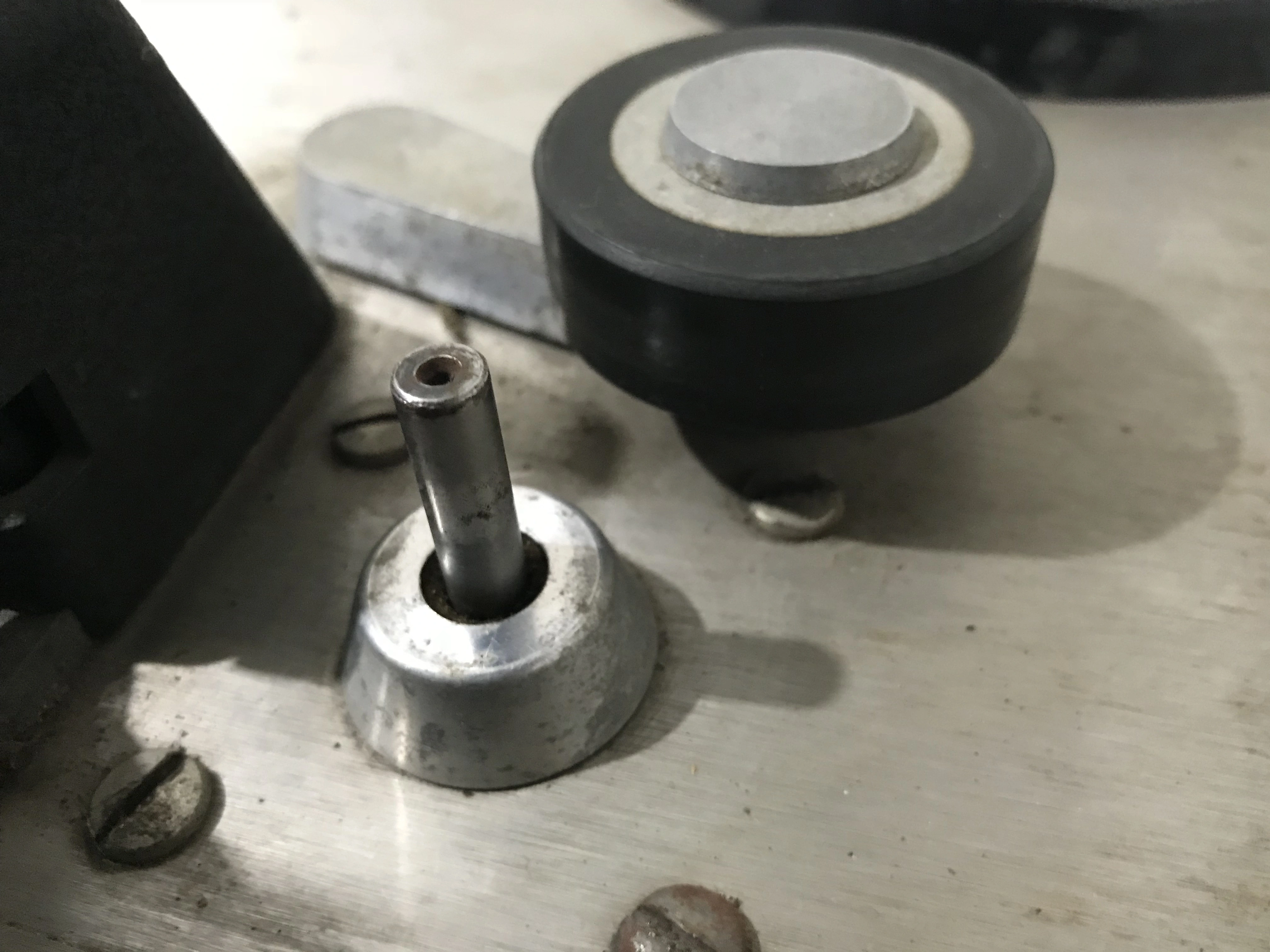

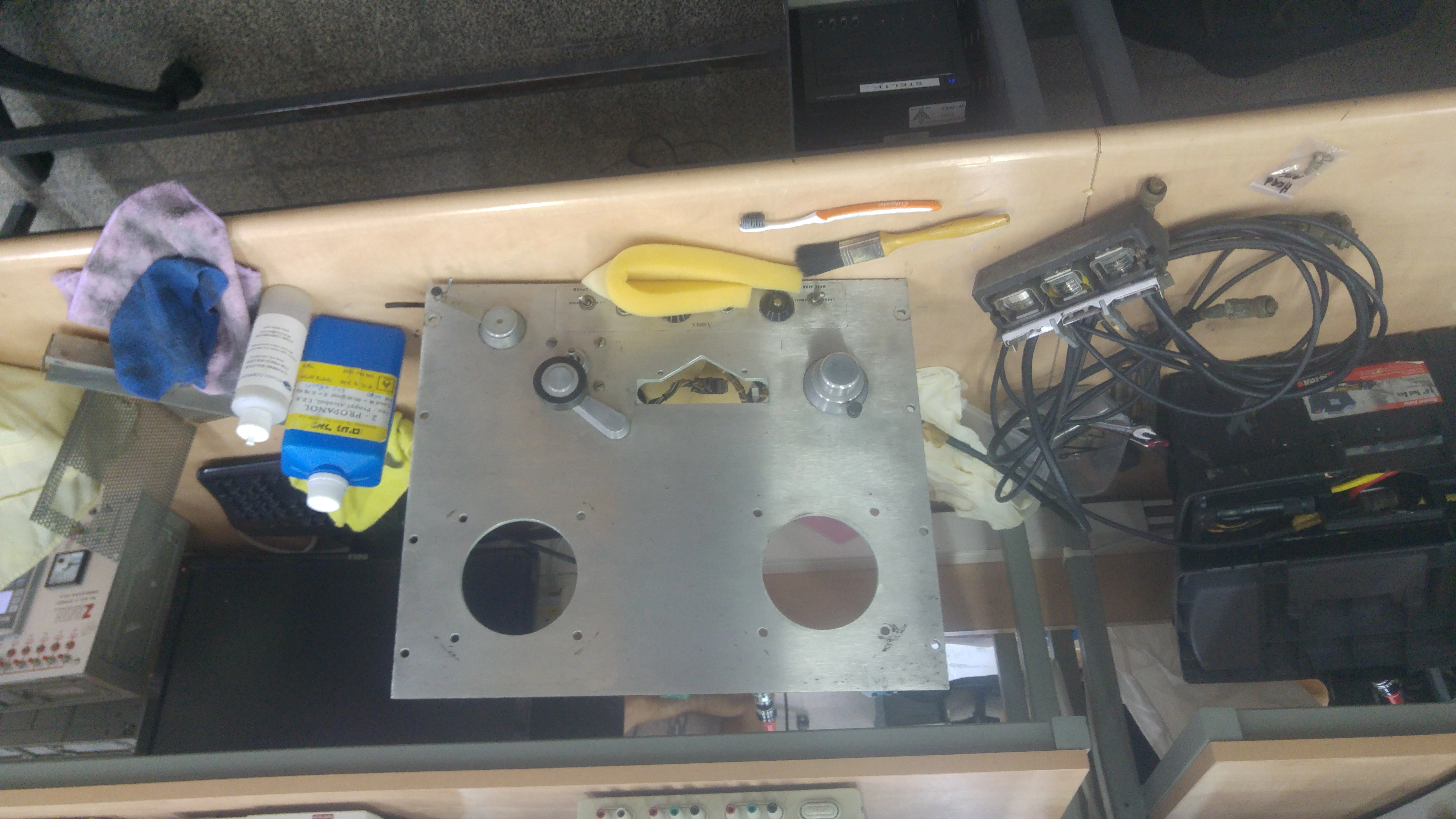

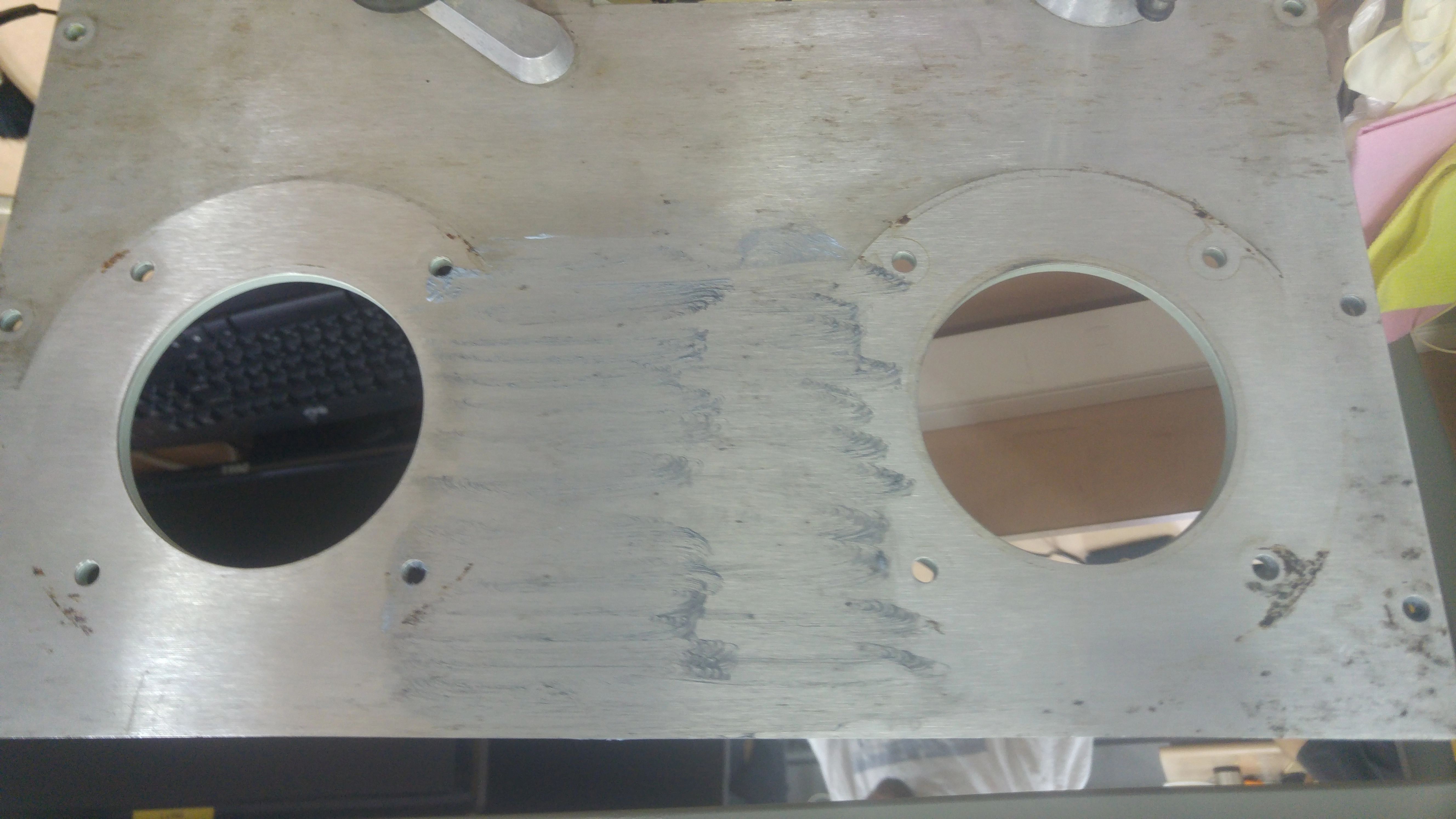

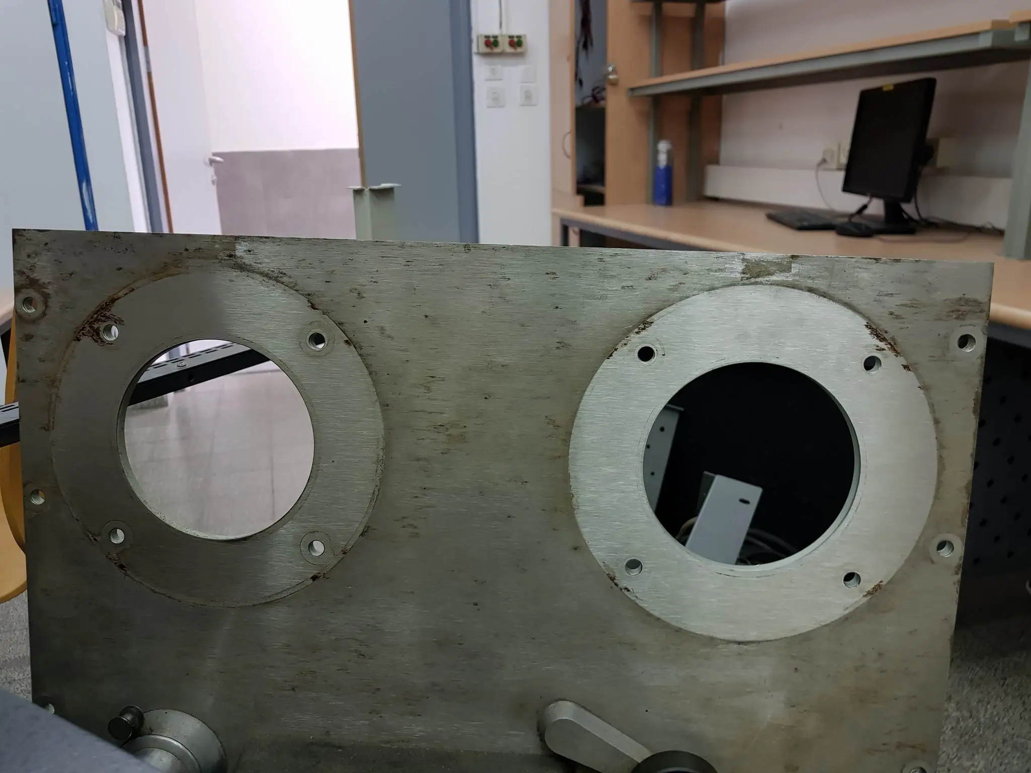

As the project going on, the whole transport is now disassembled.
The faceplate is now all shiny and clean. there are some spots that still need a rougher method of cleaning, but Peek's all-purpose solution had exceeded my expectations.
The heads assembly still needs some work. it's wires also need to be inspected carefully, but man those amphenol connectors are timeless!
I believe the heads are in fair condition . the other machine might become a source for parts if needed tho
Here's some pictures of the recent sessions.

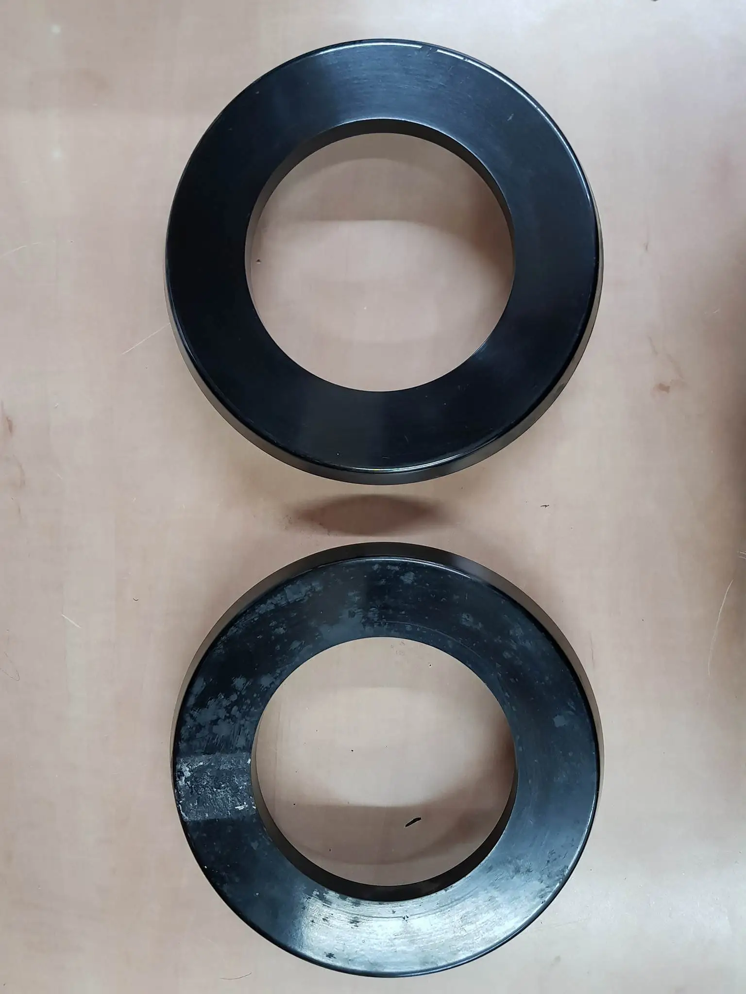

work in progress!
over the past two weeks i had 3 sessions . did mainly deep cleaning for the different parts.
this is actually how the faceplate looked at the first place:
so yes i reckon most of the 50 years old debris is gone now.

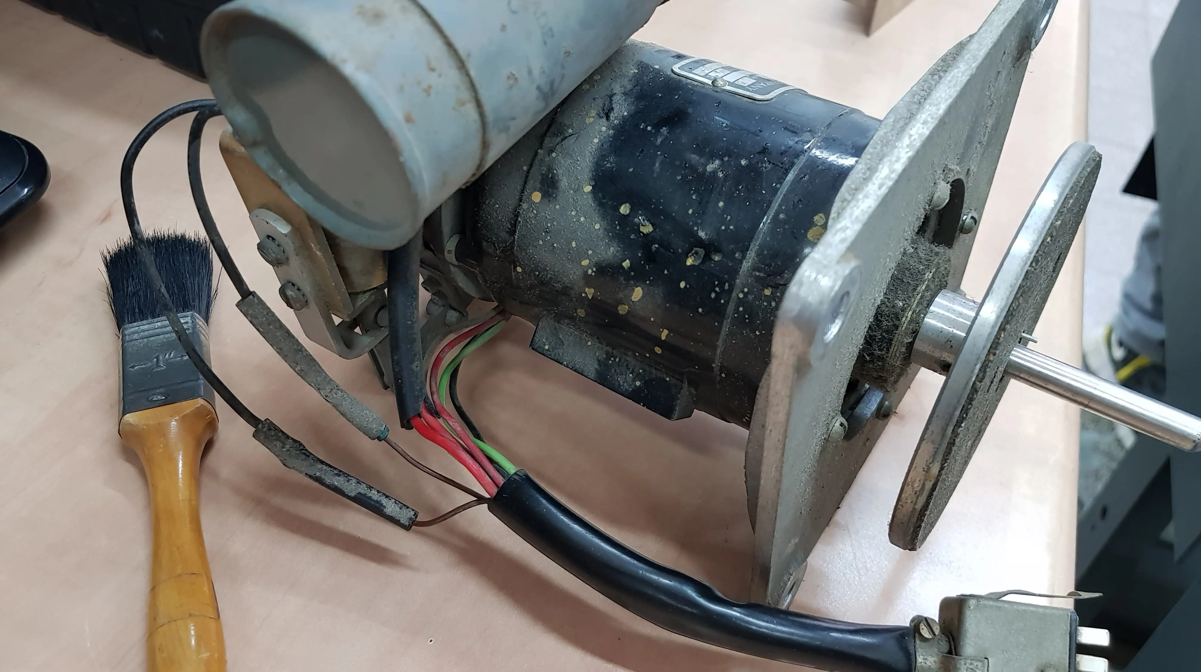

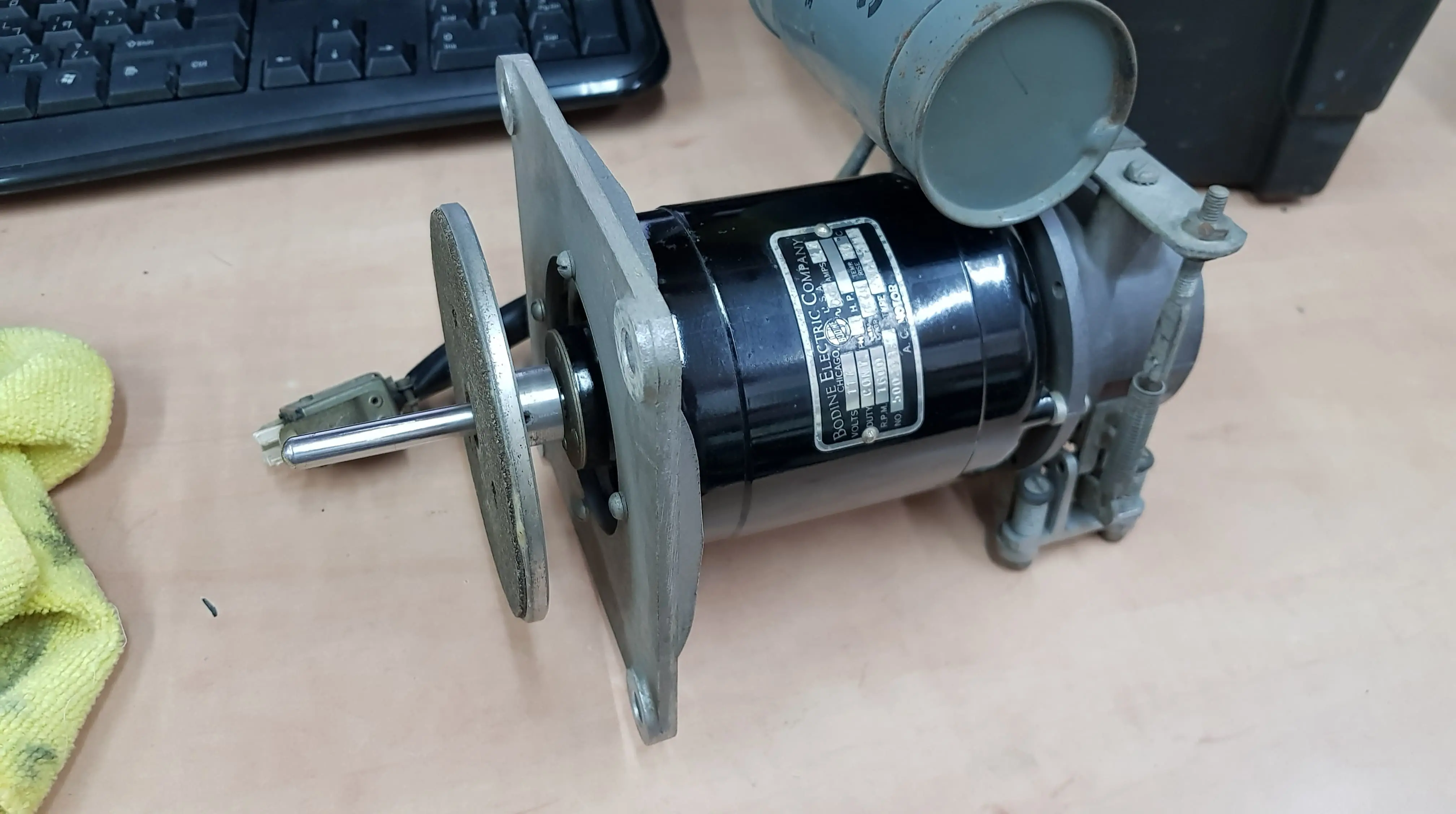

also these nameless parts are getting refurbished:
the motors :

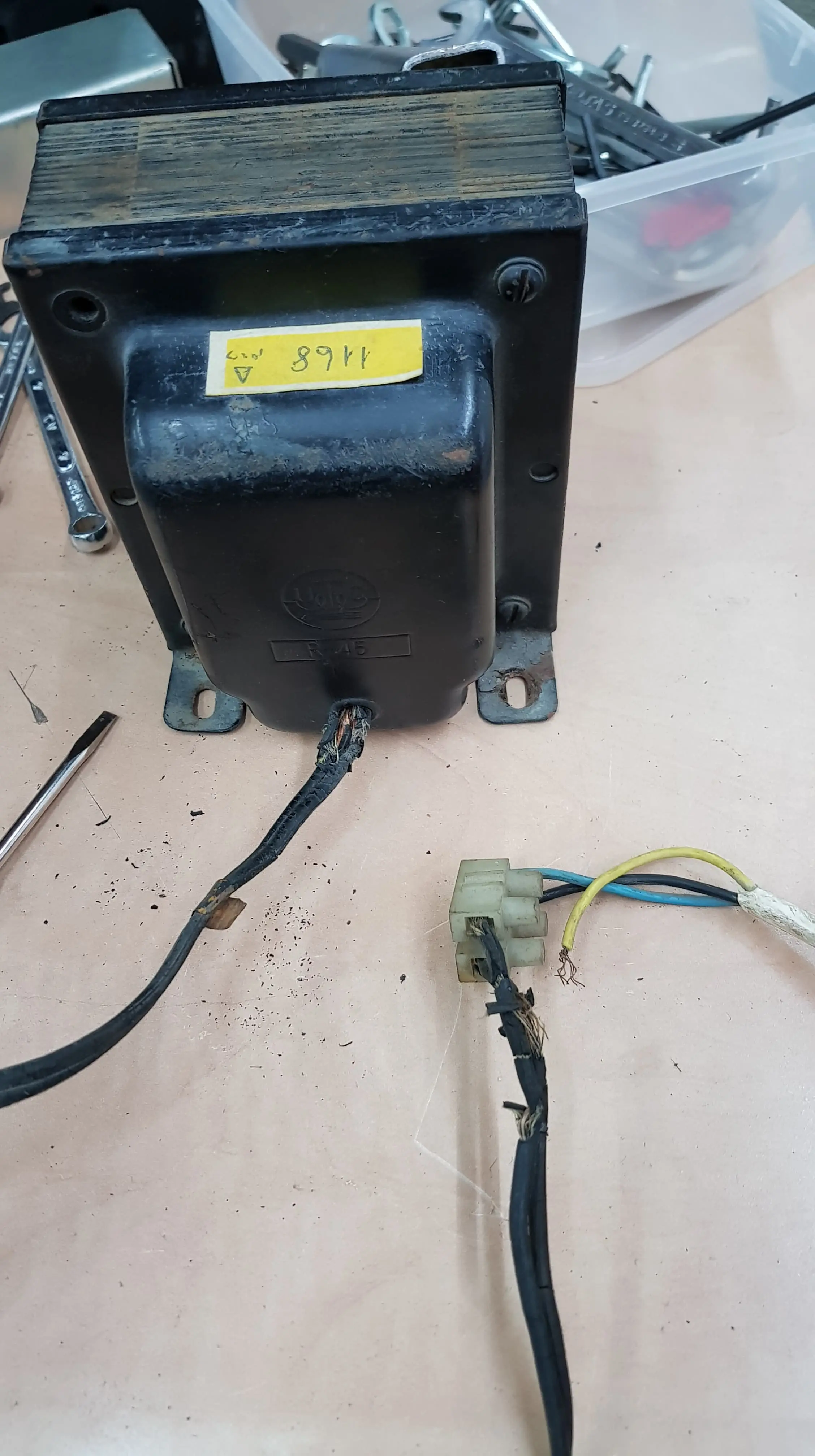

and the this bulky 110v-220v 500W UTC transformator will get a new AC cord:
up untill now i was focusing on getting the transport section as clean as i can. i kinda like this porject is getting done step by step, as this is my first true encounter with refurbishing proffesional tape machines.
up next, I will try the engage the motors and see if they run smooth as they should!also will be checking for any shorts in the control circuits box.
