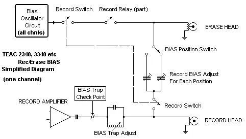

Nop. :)
There's nothing to "adjust" in respect to erase head on those machines.
There's one single Bias "Power Station" for all and it serves erase heads 'directly' (through mechanical switch and through relay switch to be more specific, and it may be a good idea to check those, maybe dirty/oxy-rusty, you know).
I've made a simplified diagram (see attached pic).
You can adjust Record Bias for each Bias Switch Position by mean of vary-caps for each channel. In "the book" it is recommended to check/adjust Bias Traps first (not sure why). You can assume that yours are trapping just fine :)
Also the assumption is that you get to the point of BIAS adjustment after you went through Play Back / Heads / Record aligment (again, that is by the book). If you assume that there's no need or no issues anywhere there, or if you simply don't care, then you can try to tweak Record Bias.

The procedure in general is: Use the fresh tape you want to use for recording, set the deck in record for the channel you are tweaking, set monitor switch to "TAPE" position , select the BIAS switch position 1 or 2 (depending on which one you going to adjust, the switch simply selects one of two adjustable capacitors).
You neet test tone Oscillator (source of steady signal, that is) to send to LINE input.
The frequency may vary (it depends), the level of the signal plus the input / output level knobs position need to give you "good reading" on the VU-meter.
In TEAC manual that I have it's 400Hz (-8dBm at input and at so-called speacified Input and Output level, which both are at knobs position pointing around "2 o'clock" or so).
So you start recording that signal and monitoring the VU-meter. Then you turn the Adjustable Cap to find the point where you get the highest reading on the meter - the Peak, and then from that point you turn the cap slightly more until the level drops a"bit".

here's diagram:

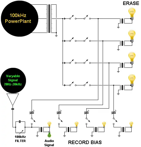

So all I can do is to look into schematics pieces that I have here and try to describe what I see there it in some sort of "easy to understand" :rolleyes: way .
So at least maybe you get a general picture about what you are dealing with.
Here I've made a different diagram for you, that shows four channels.
There is one Bias oscillator there (100 kHz Power Plant). That AC power is being "distributed" through lines, mechanical switches, relay switches, adjustable caps.
Small "transformers" represent head/tape juncture and the lamps actually represent the "EFFECT on Tape". Yellow lams are steady and green is flashing&dimming. Makes sense? :)
The "GREEN" is audio signal in the situation when you actually recording something on that channel in addition to just erasing with no input signal.
So if you look at it from this general point then you may get an idea about what to check in the "system" to get the desired "Lightning Effect".
If you have one or more "lamps" not functioning well here or there, then you look what in that system may cose the problem.

here are the light bulbs :)
