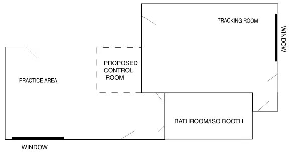

I have read the posts about control room size and the smallest I saw was 12x8. What are your thoughts on 6.5x8?
I am contemplating building a control room inside of my bands practice area (which is roughly 15 x 25 - give or take). What I am wondering is would it just be better to acoustically "treat" the whole practice area other than attempting to build a room as small as 6.5x8?
I'm pretty lucky, in that, the room off of the "band room" is a great sounding tracking room. The walls are paneled in a thick wood, there is a brick fireplace mantle and a huge window on the opposite side of the fireplace - covered with those big heavy curtains from the 70's (they sure are ugly but they came with the house). We have full size futon and two comfy chairs, plus a bookcase. Whatever the combination, it sounds really good.
My only concern with this room is that the door that leads to the garage has a rattling window...any suggestions on how to fix that? Would reglazing it work? Caulk?
I'm attaching the layout image of our space...

A studio here in town has a control room that is about that, I think. Maybe a bit bigger. You'd have to REALLY deaden the back walls at all freqs so that sound bouncing back won't reach the wrong ear, as I understand it....
Hello,
i've seen some strangely shaped studios in very odd places during my life, and I can say a fairly small console room of that size will probably give you a headache unless you mix at very low volume levels - the reflections against the back wall will be very quick. Of course, if its a true room rather than just a "space" you will need to have enough sound level to avoid hearing the unmixed music coming directly from the band.
Mixing with headphones is typically a no-no because of the perceived bass response difference compared to the actual recording, but sometimes we have to do these things.
It also depends on the size mixer you are using. A small rackmount mixer, or something about that size might be okay if you sit facing the length of the room (means your shoulders go across the narrower part of the room). You will need some serious sound treatment however.
Good luck!
Assuming you've got decent sound insulation from the band room and good absorbtion behind you, wouldn't that work?
You could keep the monitors (I'm assuming nearfields here) at a reasonable volume (since you are close to them), avoid hearing most of the band noise (because of decent sound insulation) and most of the monitor sound ought to get absorbed behind you, so it doesn't bounce back to the wrong ear.
Does that not make sense?

why think square?
even if it is small you should consider not having any 90 degree angles. This will be much easier to treat, and can give you a little more space to work with. If it wasent for that huge window, or that door immediatly across from it, you could cut a diagonal in the space and have a good size control room. Could you do without the door? :D

You're right. Square is bad for audio. Most pro studios do not have square console, vocal, or kit rooms. Of course, its difficult to make octagon sized rooms 4'x4' :)
That aside, even simply making one wall slightly slanted about 10 degrees goes a long way in a vocal booth. Console rooms could be trapaziods. There are tons of resources on the web for building your own studio with designs. I don't have them bookmarked on my laptop here at work, but I searched www.google.com for "home studio design pictures" minus the quotes and viola, after an hour of weeding through dopey URLs I found quite a few pictures. Nothing wrong with taking what the pros do and scaling it down.
