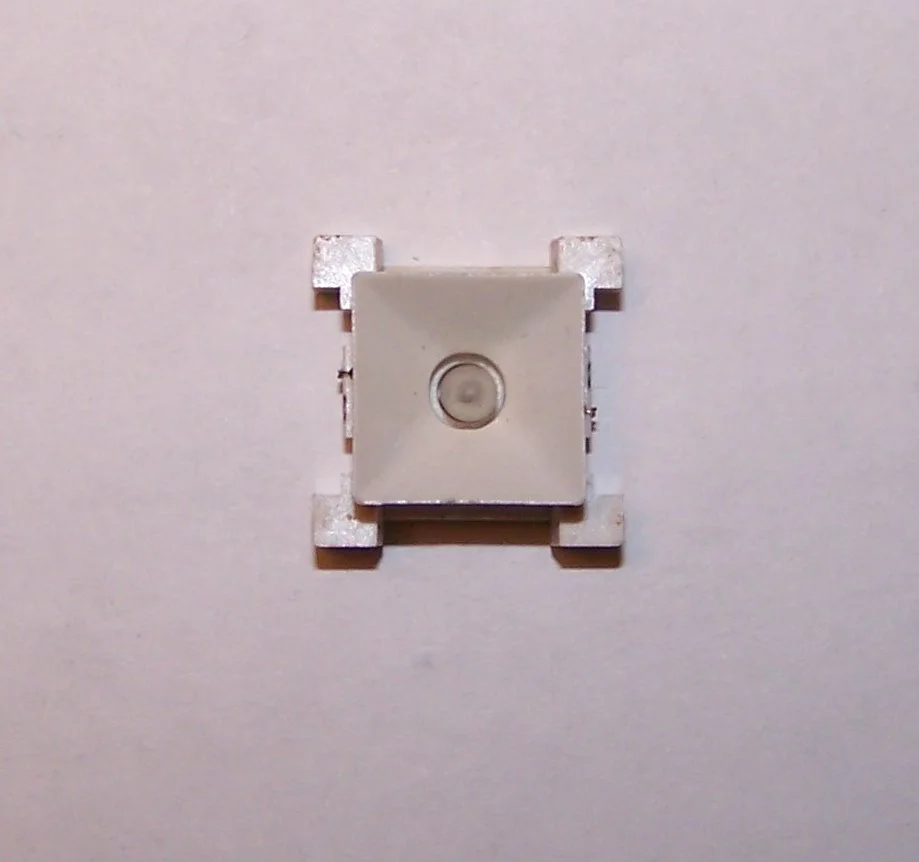

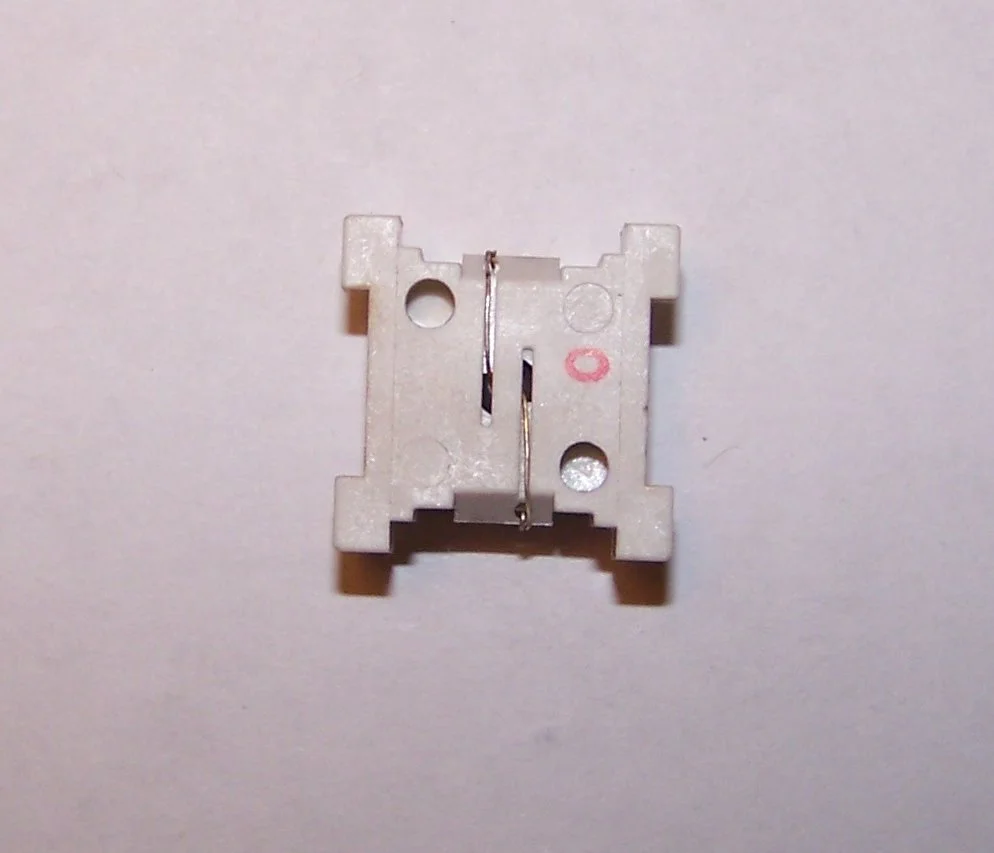

These are the best pics I could get. The lamp is a grain of wheat type. The two leads wrap around the bottom of the holder. What do you make of this? Thanks.
Wow, Ed...so is that all one assembly or is it possible for the LED to come out?
Ed, another thought...LED's so rarely go out...I mean, they have a really long life and typically they don't go out unless they've been overloaded. Are you sure that power is getting to the LED? Have you tested the LED with a diode tester or even with a couple AA batteries or something?
Yes, my father in law checked and it's the light that is the problem. They are not led's they are incandescent lamps. Would you go to LED's? It might be a good idea.
OH! My mistake...looked like an LED...what's the voltage on the rail driving the lamp?
dodgeaspen, I think I gave you the info on TTP website regarding those lamps, if not, let me know and I can dig the info out again, you can get them at Mouser, they are a Chicago Minature lamp, 5v...
